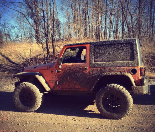

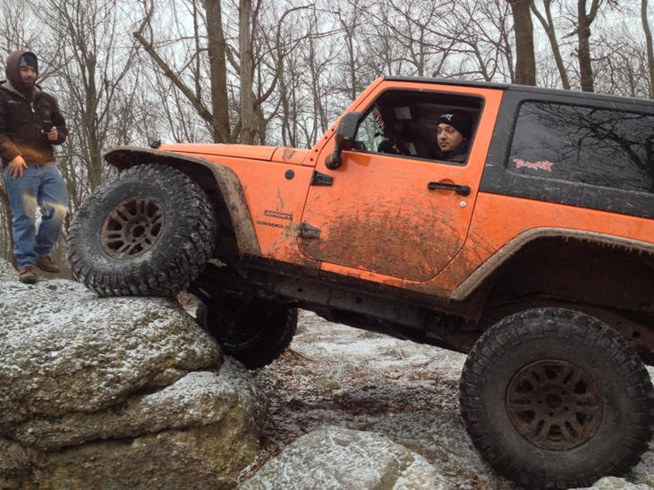

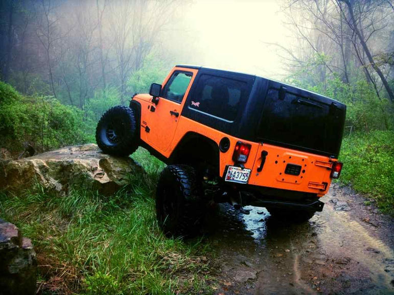

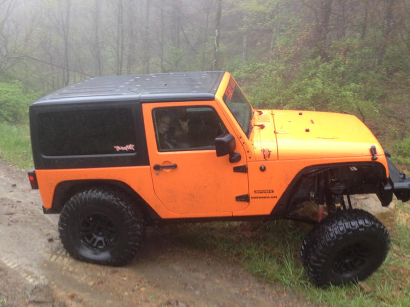

Nah, 2.5" is perfect for 35's. You will have no issues whatsoever if you cut your fenders. Here are some pics with full fenders but I haven't wheeled with it with full fenders, so can't speak to rubbing there. I can tell you I wheel pretty hard tho on 2.5", 35's and cut fenders, and never rubbed anything. Only thing you'd wanna do is trim the rear pinch seam. I would also still find out what brand coils they are putting in.

Here ya go. You'll be fine with stock rims and 35's but you would just need 1.5" wheel spacers
