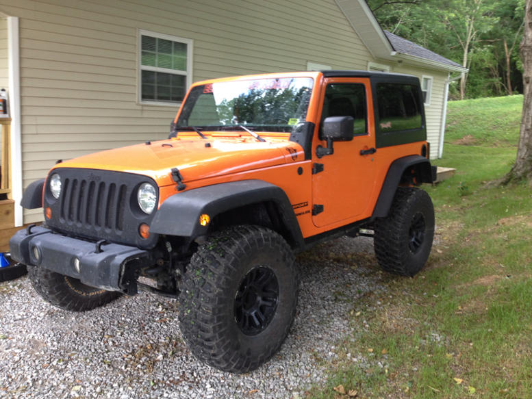

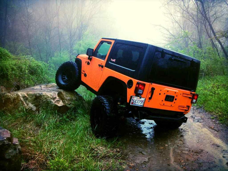

Attachment 465558Attachment 465559Attachment 465560Attachment 465561Attachment 465562
Here ya go. You'll be fine with stock rims and 35's but you would just need 1.5" wheel spacers
Awesome jeep! Thanks for the support as well. Do you think the 3.25in suspension lift is to much, would I have to alter anything with that size. I really like the look with out the spare, might find a used tire and just get a rim and take it when I go wheeling. I just don't want to look back in four months and say damn wish I had the bigger lift.
If you think you're going to stick with 35's I see no reason to go over 3". 3" is the limit for stock driveshafts. Over that, you are going to see fast premature wear. I personally like the lower COG for those off camber situations. Is it a two door or 4? If it’s a 4 door, doesn't hurt to have 3" or so for a little extra belly clearance, but 2.5" is still fine and perfect for a 2 door imo.
