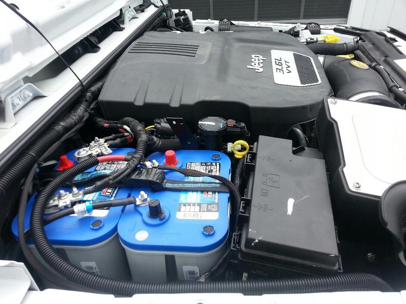

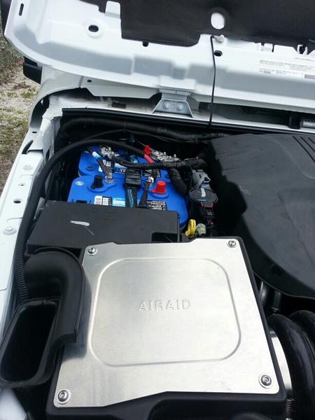

Ummm no I am not saying replace every wire that goes to your battery with new two foot longer cables. I am saying just rotate the battery in the other direction and connect it. Click image for larger version

Ummm no I am not saying replace every wire that goes to your battery with new two foot longer cables. I am saying just rotate the battery in the other direction and connect it. Attachment 433888Attachment 433889
I think I'm going to go with just one Dual purpose Marine battery. I really don't feel like making space to put a 2nd one in there.. Its more just being lazy than anything, but I think 1 blue top will run my winch and 14" light bar with no problems.
Dude how did you free up that much space to get that 2nd Blue top in there?

You can just remove your stock battery and toss in a blue or yellow optima 34 or 74 right in its place without an issue. Just turn the single battery facing in the opposite direction facing back instead of forward and it will plug right up. If you get the one with the posts and terminals it makes it very easy to wire in things like a winch, lights, etc.
Fitting two in required a custom tray, a bit of cutting and moving a few things around. along the firewall i have a switch and mounted relay/isolator as well. That lets me control how I want to charge them and lets me dial in how I want the auto shutdown on the second battery for my full time fridge I run. I run the deep cycles because honestly you just dont need the starting power even in cold weather and AGMs actually produce more power if you crank cycle them to warm them if it is really cold out. Cant really do that with a lead acid battery. Overall Im very happy with my setup. There are many ways you could go with batteries thou.
