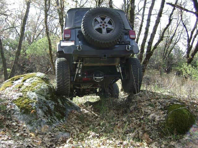

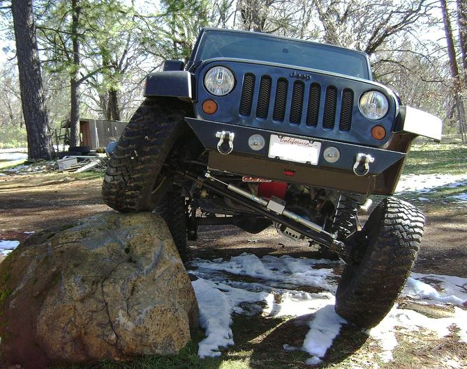

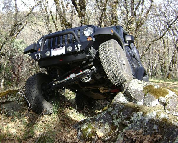

If you install all 8 adj control arms, you can get away with stock drive shafts. Given the rear especially will need replacement at some point. I run 3" EVO plush coils with 3/4" spacers w/ Fox Remote res 2.0's, all 8 adj arms on oe shafts. Less than a yr with abuse, and shafts are fine.
