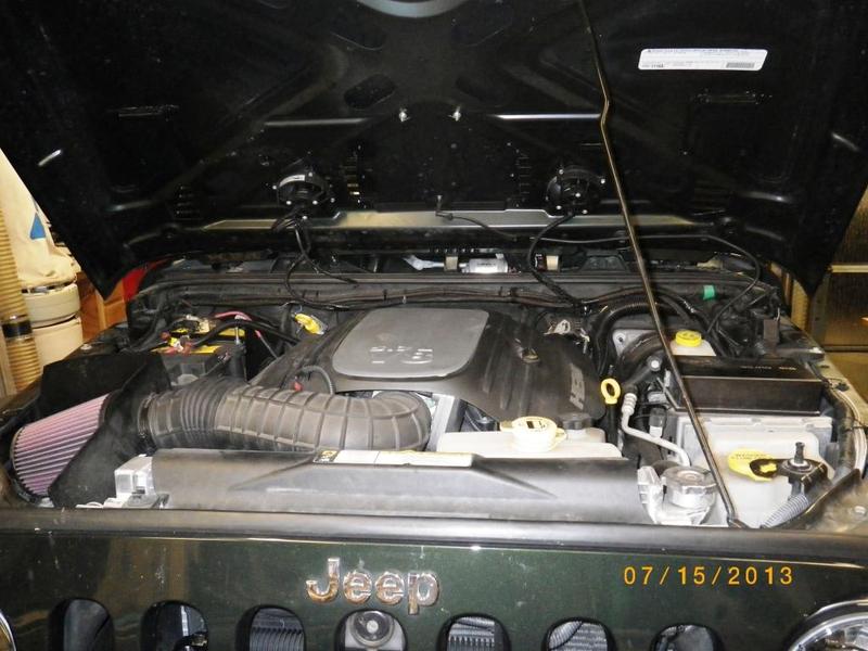

Essentially it was the AEV install with a new larger radiator and electric fan. It was done by a local shop Screamin Lizards in Bedford, Texas this past January. It is running a new program update from AEV also.
Added a picture of hte radiator and over flow might give you a comparison.
