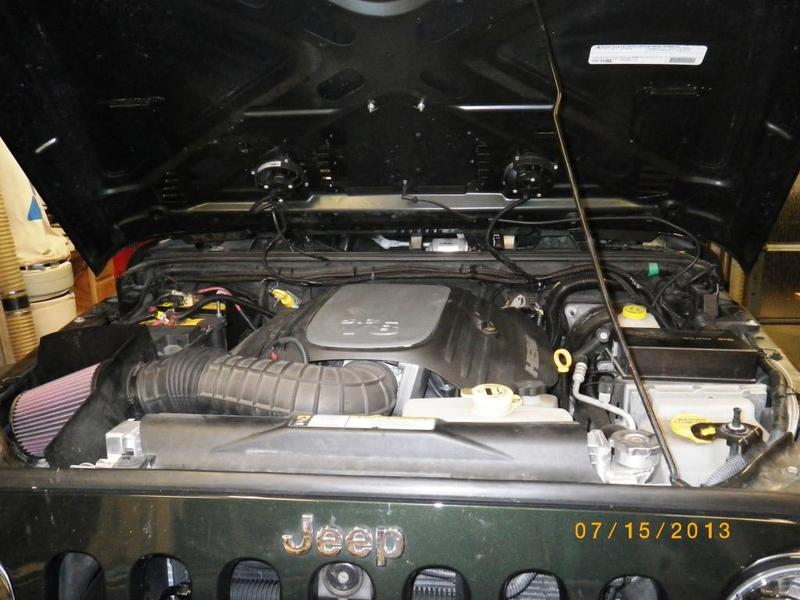

Originally Posted by 4wdave
Essentially it was the AEV install with a new larger radiator and electric fan. It was done by a local shop Screamin Lizards in Bedford, Texas this past January. It is running a new program update from AEV also.
Added a picture of hte radiator and over flow might give you a comparison.
Attachment 479199
It looks like I run the same AEV kit and radiator as you, except with a 6.1. I still have the electric fan. In 90+ weather at highway speeds or crawling my coolant temps do not exceed 215. At crawl speeds the fan runs at high speed though, roars loud enough it can be heard in the cab. Underhood temps are pretty warm, but never had an overheat. I am still running whatever AEV programmed in back in 2009.
Something is certainly not right. No way you should be overheating with that kit and the AEV radiator in only 90 degree temps.
At a crawl, when the coolant temp gets to 212 degrees or so you should be able to hear that cooling fan from inside the jeep very clearly. In high speed mode on mine it is pretty loud and I can watch the coolant temp fall when it kicks in.
Maybe it is just a weight thing, I am still under 5000 lbs. But like stated above I would suspect the radiator if the fan is working properly.
