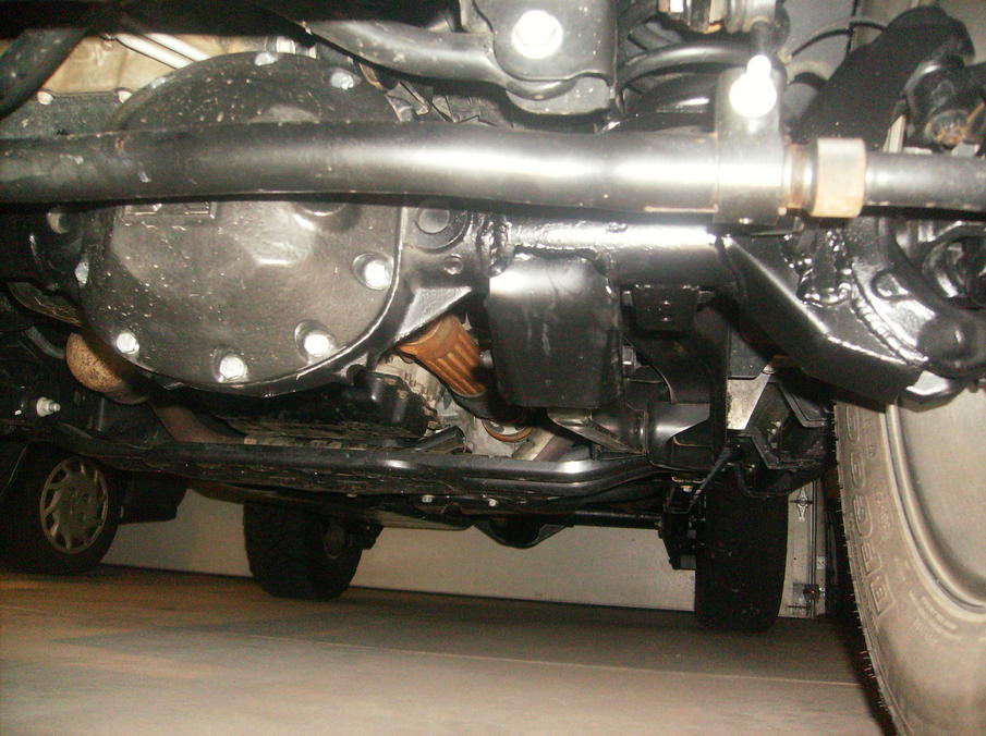

After my experience I completely agree with you. If I could do it again I would have just used some Rustoleum and if you really want paint the logo with the touch up paint of your choice.
I used Duplicolor engine paint which is great looking but it required primer and the final coat took 5 days or so to cure. I used Mopar Bright Silver touch up paint to hand paint the logos. Rustoleum is good to go in a couple hours, so if/when I need to perform touch ups I'm going to use that instead.
I installed these last weekend!
Rear Installed....
Front Installed...
Close up...
When I screwed up and used clear coat (engine variety)...have since sanded and repainted semi gloss black:

That's just back hammered finish Rustolium. No Clearcoat, just reflection from the flash.
