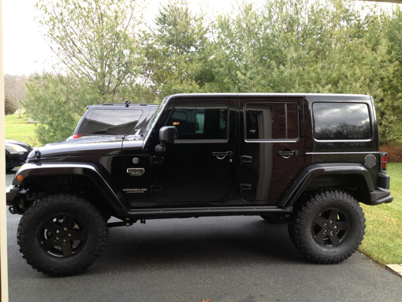

Looking for some suggestions on some tow hooks. I will be painting them green to match the MW3 badge on my all black JKU. Lets see some!

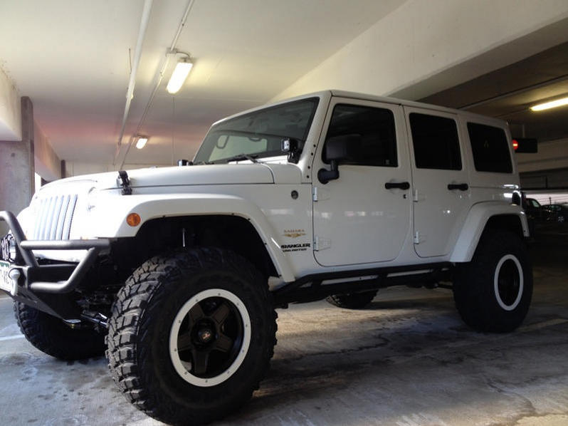

I painted my d rings
Sanded with 220 grit sand paper, washed with soap and water and let them dry for an hour or more. Then 2 light coatings with self etching primer. Then 2-3 light coats of automotive enamel (any good paint would work, the auto enamel just matches my white well and is made for high heat). Let them dry over night then install them.
I made a little rack and used wire to hang the pieces in the air to paint...made it easy to spin them around and coat evenly...just a tip.
I also painted my rock guards on my wheels te same way.

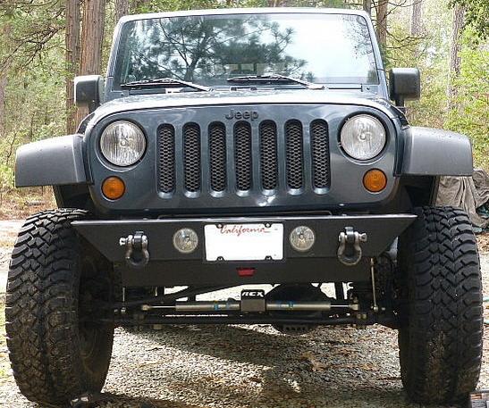

yeah I just rattle can them. If you'll be actually using/needing them, good chance they're gonna get scuffed any how. I used dark silver metallic on mine to match my wheels. EDIT: I used wheel specific paint from auto parts store.
