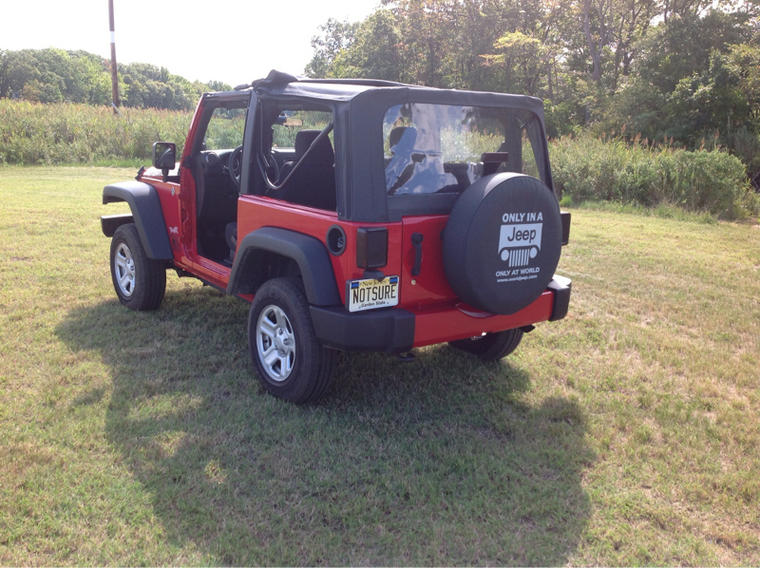

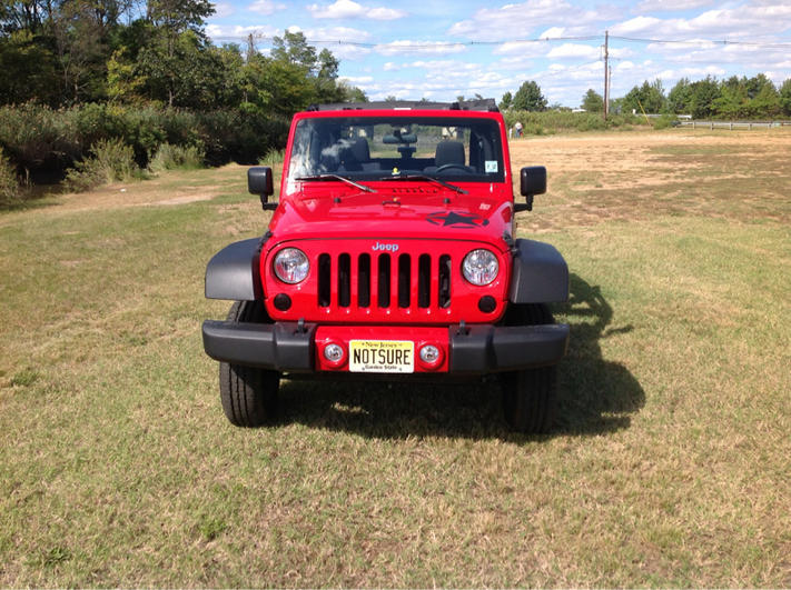

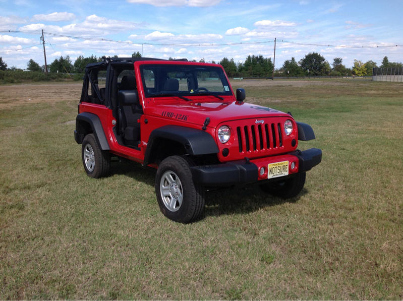

Well here are the pictures. Like I said I'm no pro in painting. But it looks nice.

Old Sep 16, 2012 | 11:31 AM
Sommer13's Avatar
Posts: 532
From: Austin, Tx
Nice job on the overlays man, great look with that flame red color, they really pop out! And your LP is funny
