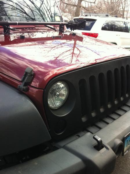

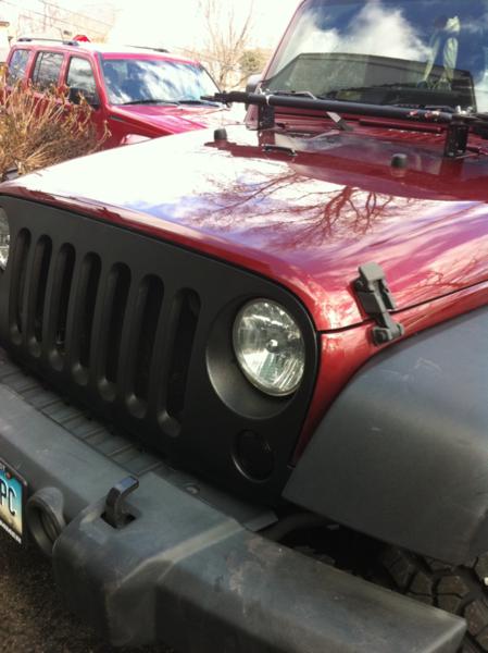

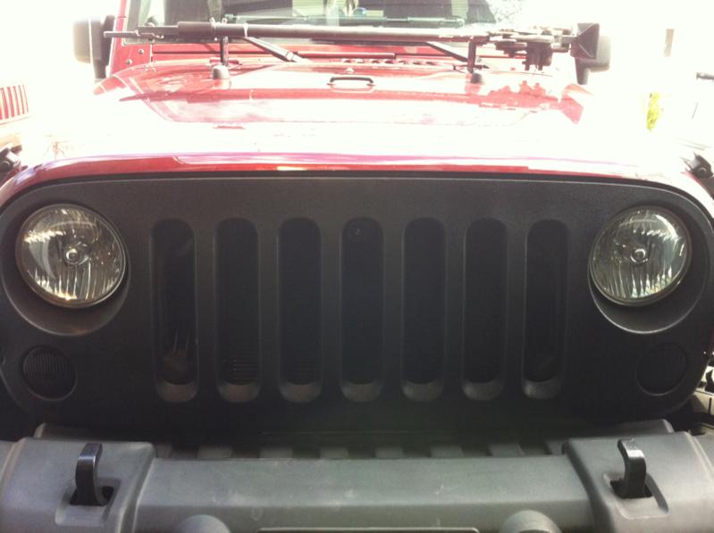

Bedliner on my grill it is flat black right out of the can no need to paint over it. I picked mine up at the local napa.
I used VHT nightshade to tint the turn signal lenses
And yes you have to sand first then prime then paint. It won't hold if you don't follow these steps
