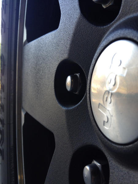

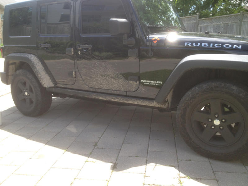

What do you mean it will scrape off?
I used rust-oleum bed liner on mine. I just painted the face of the wheel, masked off the inside of the rim before I sprayed it on. Didn't use primer, just scuffed it up with sand paper. It is holding up great with no signs of peeling etc.

Looks great!! How many cans did you use i read on one thread he only used 2 cans?
Thanks! I used two and a half cans for all five rims if I remember right. Did them over a month time period because I didn't have much time to do it and it's a lot of time consuming work to do it right.

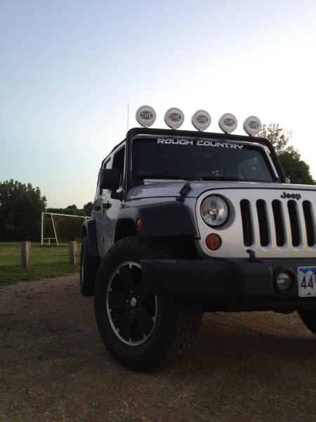

Love BEDLINER!!
