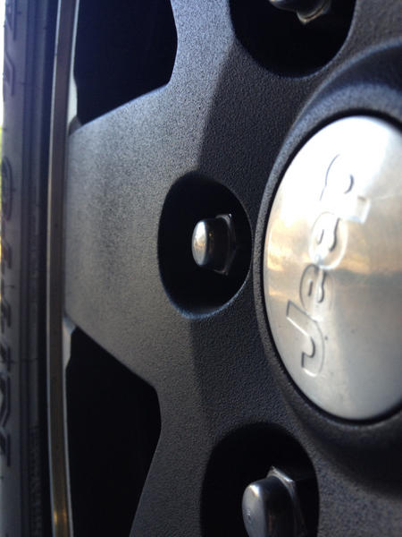

I'm in the process of doing this. I've got the wheel off the tire though. So far i've sanded with light sand paper, then went back over with a softer sand paper. I cleaned with alcohol then sprayed three seperate light coats. I got my roomates blow dryer, and that speed the process (highly suggested). That's it. It took no time. Tommorrow I will do the inside. Ps I used 1 can and 3/4 of another for two wheels, and i'll probably buy two more to finish the other three.

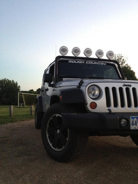

I used rust-oleum bed liner on mine. I just painted the face of the wheel, masked off the inside of the rim before I sprayed it on. Didn't use primer, just scuffed it up with sand paper. It is holding up great with no signs of peeling etc.
Attachment 334222
Attachment 334221
Wow, looks awesome!!
