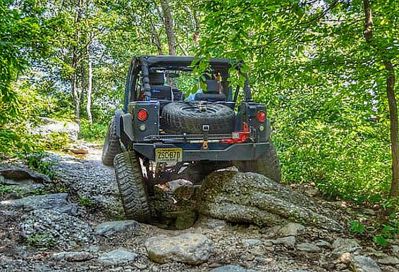

Haven't been on in a while but this is what I ended up doing

Originally Posted by Buddylove
Looks good The Black Jeep of The Family
yea I love it just sucks it's gotta go back on this winter
