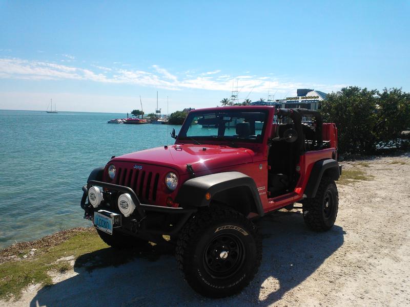

Pic request for 2.5" lift with 34" tires

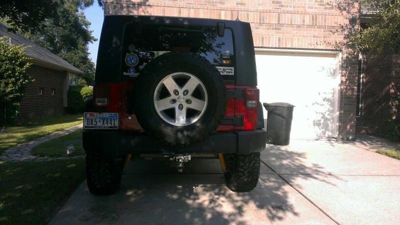

OME lift with cooper discoverer STTs
Sent from Chew Crew HQ

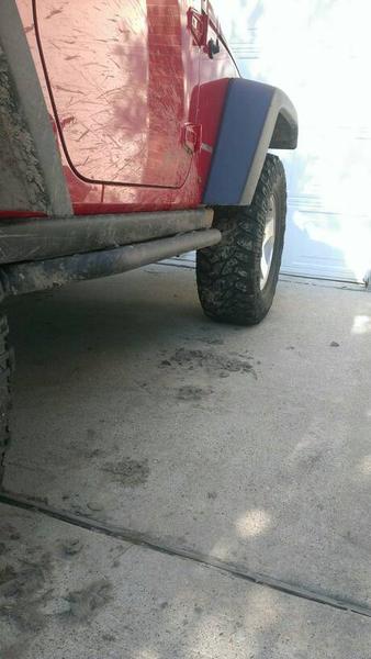

17x9's
GY MTR Kevlar 305/70/17's
Teraflex 2.5 coil lift

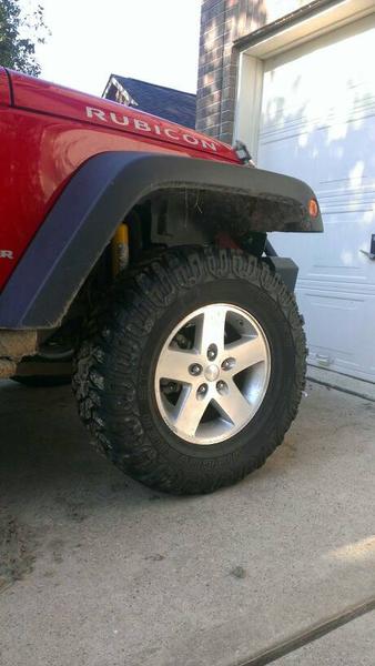

Teraflex 2 1/2 coils and shocks (4dr)
Toyo MT 285/75/17

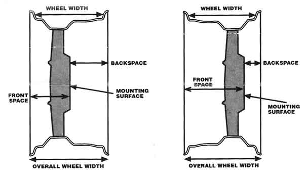

No problem. Took me a bit to get my head wrapped around BS as well. The stock JK has a BS of around 6.25" I believe. When you lessen the back spacing basically the tire sits out past the fender and is less likely to rub. 4.5" of BS is ideal you will not rub nor will 4.75. I don't have 285's so I am not certain if they can be run on stock wheels without rubbing but I can't see why not. Try test fitting one and seeing first. But if you have 4.5" of BS you will be good to go.

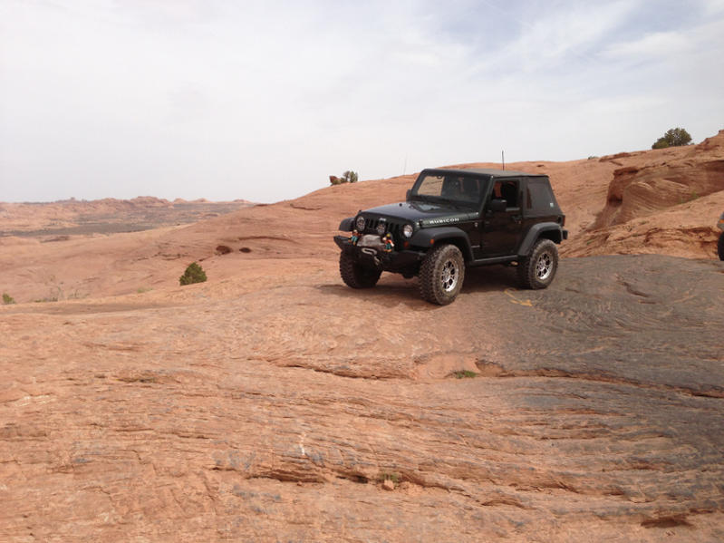

Default 2 door JK with 285/75R16 fierce attitude tires and old men emu HD lift 2.5"
you didnt specify 4 or 2 door.. so here is mine..
