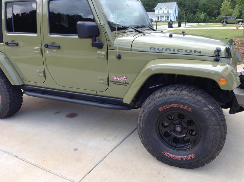

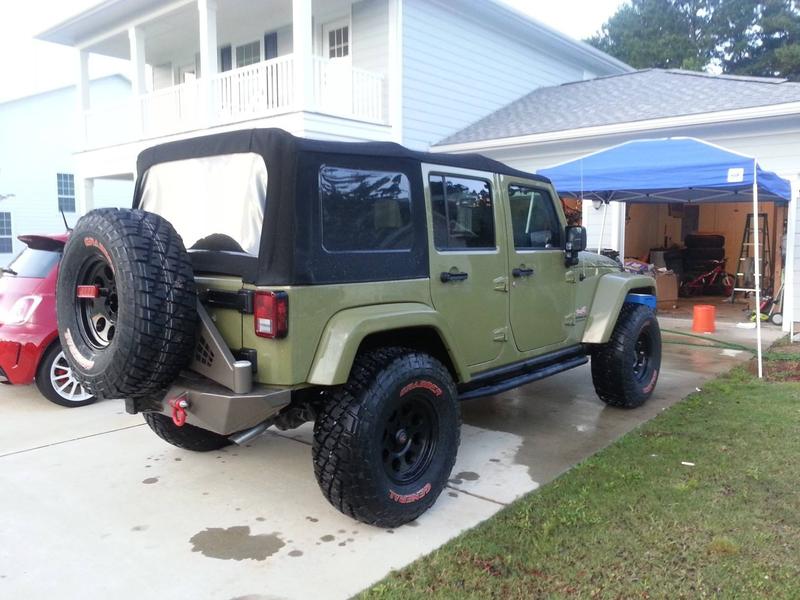

Default 2.5" teraflex spring kit with 315/75- 16 general grabbers
I could make them rub by fully flexing the rear end, they would just touch the edge of the flare. I did have to trim the rubi rail back about an inch. The generals measure 34.75"Click image for larger version

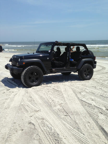

2.5" Rubicon Express with 315/70 17 Goodyear Duratrac's

Nice!!! Did you have to use spacers?
