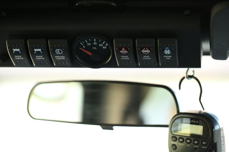

As for the exact location I'm not an expert but I can tell you the higher rather than lower and in line of sight is best I at first located mine on the right side of a SPOD. And found it to be a stretch when I wanted to actuate them. Another example is the factory location down low and hidden by the steering wheel, I guess you can get used to it but fumbling for it and then looking down to insure engagement takes time and ones eyes off the trail. I made the compressor switch one color (green) and the 2 lockers different colors ( rear-yellow, front red) so just a glimpse gets a very quick update on what's on. Just my .02 cents.

I used the similar panel on my '07 for the locker switches. View is a bit hidden by the steering wheel, but it works. Once I installed an sPOD, I replaced that panel, restoring the original look. Another advantage of the sPod: Easier to install backlit switches with custom labeling (though that can be done on the steering wheel panel with more detailed cutting involved), and you can add an oil pressure (or air pressure, should you prefer) gauge. You just need to ensure you order the correct sPOD control panel (they make a number of different configurations--with and without dual lights, and with and without a gauge opening).
