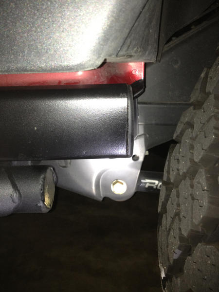

Does any one have pictures on where to cut the pinch seam.
Really hard to tell, but I only cut the rubi rail about 1 1/4" and angled the seam. I think this will be ok, but I havent tested it yet.
