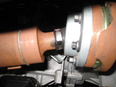

This is 6 degrees. Should the angle at the xfer case look like this. I was considering backing off a bit, but it drives nicer where it is currently.

I'm running 7.1 degrees on each side right now with the stock front shaft on my 2 door. Doesn't seem to be any problem at all.
I've got the JE Reel 1310/yokes front on the work bench waiting to be installed (already did the rear 1350) but I'm afraid I'll have to set it back to the 5 to 5.5 degree range to get rid of any vibrations so I'm enjoying cruising with the stock unit for now.
Probably tackle it tomorrow, so wish me luck!
