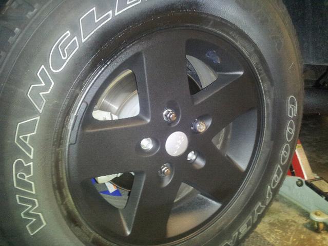

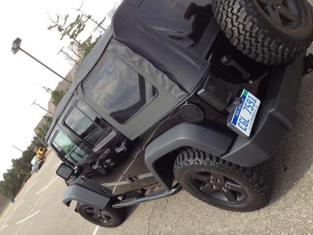

I initially did 4 coats with the wheels off and 3 more with them on. If I had to do it again I'd leave them on.
Clean them thoroughly with rubbing alcohol, tape over the lugs w blue tape, same with the valve stem. I also taped over the center cap and then exactokniffed around the circle for a clean line.
First 2 coats very thin then start going thicker. I made construction paper cutouts (think two half-donuts) and placed them behind the wheels while spraying and had no issues.
Wait about 20 minutes between coats, maybe slightly less if it's warm out (I waited 20 minutes in a ~50 degree garage). I also found no overspray on anything in my normal sized garage FWIW. Ventilate well though as this stuff is stronger than regular spray paint. I was high as a kite (hence needing to apply 2 more coats the next day!)
It's very forgiving so you don't really need to worry about runs etc that normally come from painting on a vertical surface. It seems to 'melt' in to itself leaving a smooth finish. I've had mine on for about 6 weeks through normal highway driving, trails and mud and hit them with a pressure washer 4 times so far with no peeling.

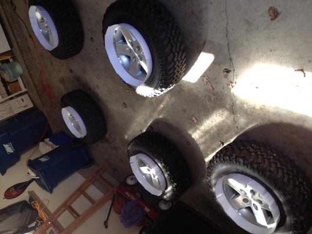

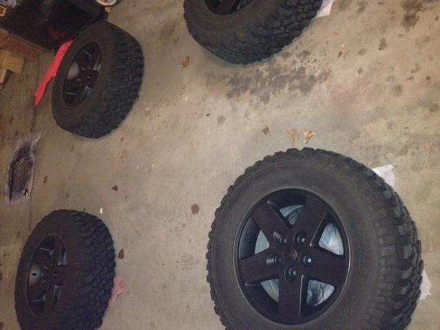

Did not affect driveability one bit. I took my wheels off and used index cards in the small slot between the tire and wheel, 2 cans did 5 wheels 4 coats each. Don't spray on too heavy nice full light coats. I recommend removing the wheels for sure if you want a perfect job and to get inside of the lug area as well, using tape will be shoddy and removing the tape will remove some of the plasti. I will update with pics in a few. I did this last weekend but havent loaded pics.
