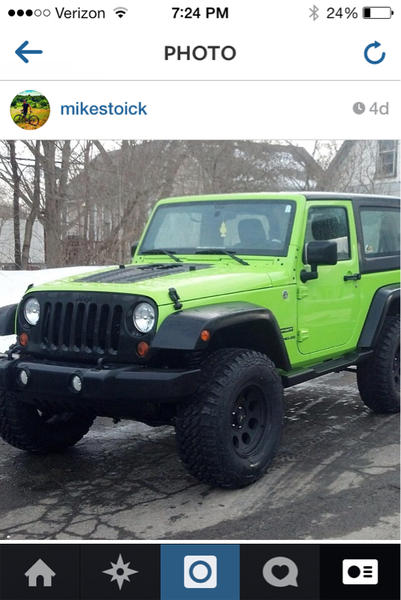

I think if i went to 33s i would have regretted it. Go 35s and dont look back. I have the 321 gears and an auto: what many call a terrible, unrunnable tire to gear ratio. Its fine for now. Reprogram with the aev procal and youre set. Heres my 13 jk sport on 35 in procomp mts and an aev 2.5 in lift.

Also take a look at my profile pic. Looks btr dirty no doubt
