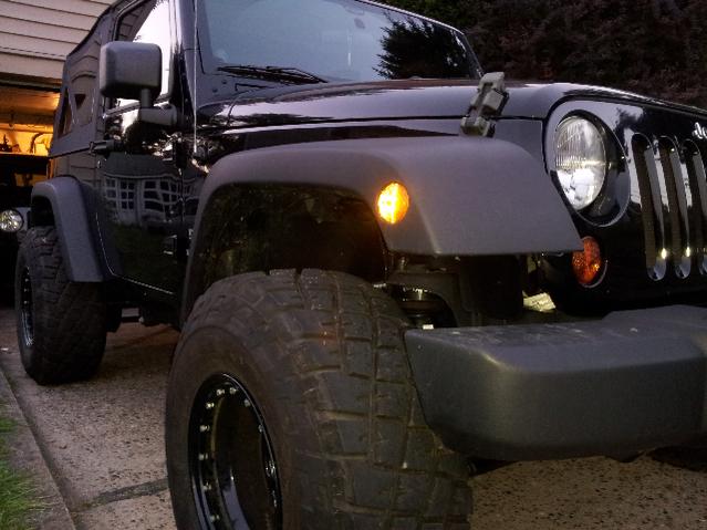

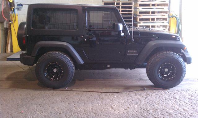

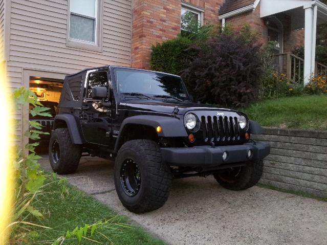

So what's the general consensus? I think Im going to install them cause it seems in helps with the added length. I received them from ups today and plan on installing it either Saturday or Sunday. Along with the softop. ill take some before and after pics!
Well i installed the softtop on Friday and did the bb on Saturday. supertop wasn't bad. the BB however was a pain in the ass.
New rear sway bar links didn't have the zerk fittings however, zero fittings came in a little baggie with the kit. but there were no place to install them. anyway, it was a pain and took me from 10:30a.m. To 8:00p.m.
But its all in now and Im happy with the finished product!
Before:
After :
Before:
After :
