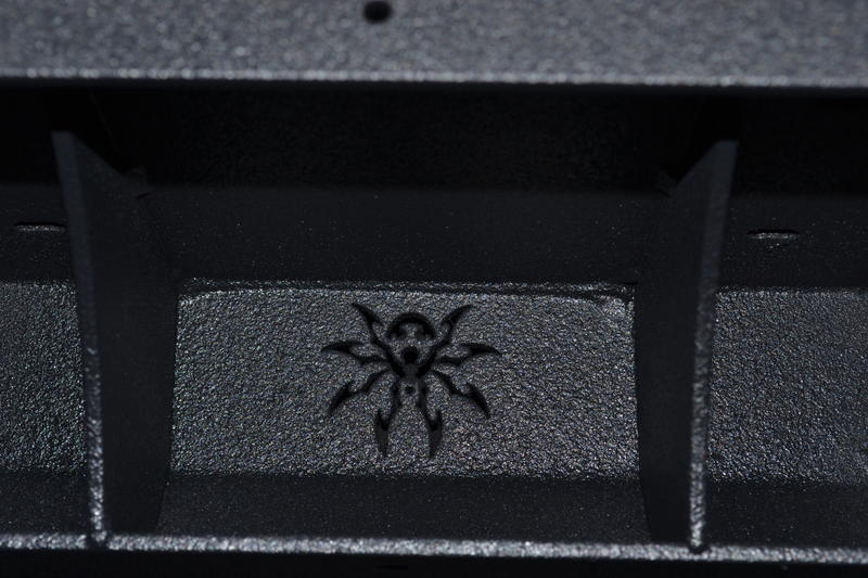

You'll only need it along the left and right edges. The top and bottom edges are pretty close to the spyder. If you run across the top and bottom edges, then you's be able to see the tape. Trust me, this I know from experience. Here is a picture of the backside of the bumper's spyder section. you can see what I mean. I also believe that not having any tape along the bottom will improve draining in the event of water infiltration through the spyder, which will most certainly occur.

Old Jan 13, 2012 | 10:16 AM
  #93
SergeantChuck's Avatar
Posts: 676
From: Cabot, AR
I am definitely going to use this method.
