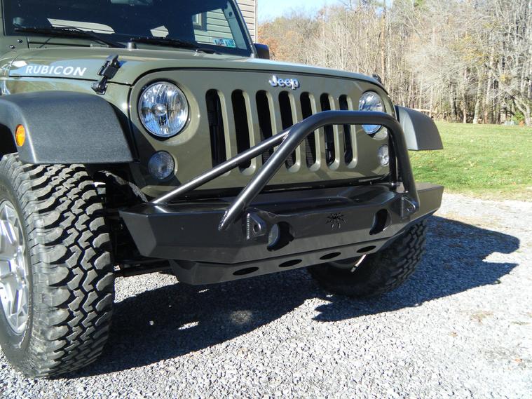

Just finished the install of a Poison Spyder Brawler Mid Front Bumper. I really liked this bumper due to it combining the bumper and the winch mount. Installatiion required minimal modification. I opted for the Skid plate that bolts to the bumper. This protects the Swaybar disconnect motor. There is a very small amount of trimming on the JK frame mount that sticks down and hit the skid plate. Roughly, 1/16" needed to be removed. Simple step with a cut off wheel gave me the clearance needed. I decided to get the whole assembly powder coated in Satin Black. If anyone is interested I am posting the stock, 2015 Rubicon bumper for sale. It stills has the factory crash plate on it. Includes all nuts, washers, plates etc.
