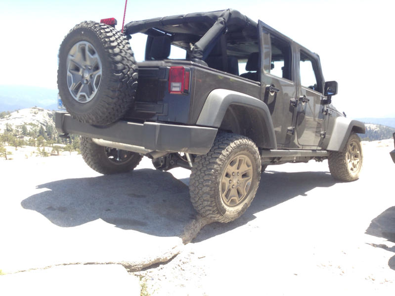

I have a vr10000S winch on stock bumper with rockhard4x4 winch plate and a mopar front skid plate so up front I have about 100 or so extra pounds and back is stock bumper. my spare weighs about 85lbs. I got exactly 2" up front vs my stock 19 front springs and 1.5" in back vs my 60 stock springs. It rides and handles great.
http://s743.photobucket.com/user/jad...e%20Lake%204x4

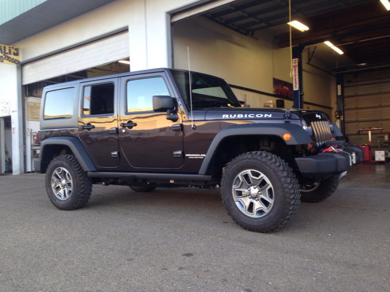

I got just over 2 inches, have a mid width bumper and winch up front. In the rear I just have tools and spares that I carry. The shocks are the bilstien 5100 for up to 3 1/2 lift with extended brake lines. Can run longer shocks but run into drive shaft problems. Very happy with what I have. Now just larger tires.

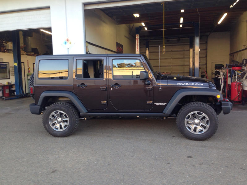

Here are some pics on flat ground
