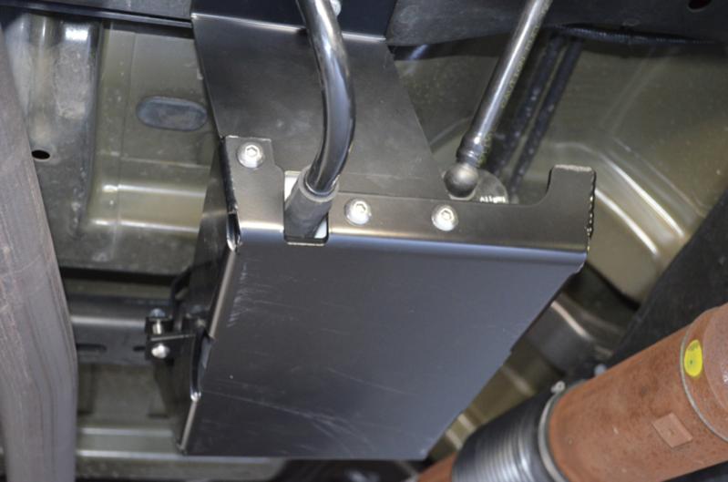

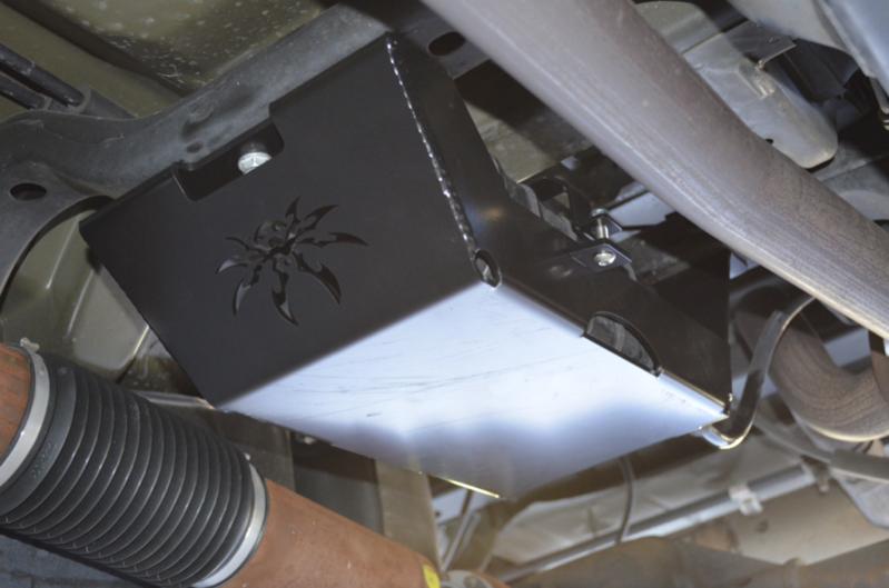

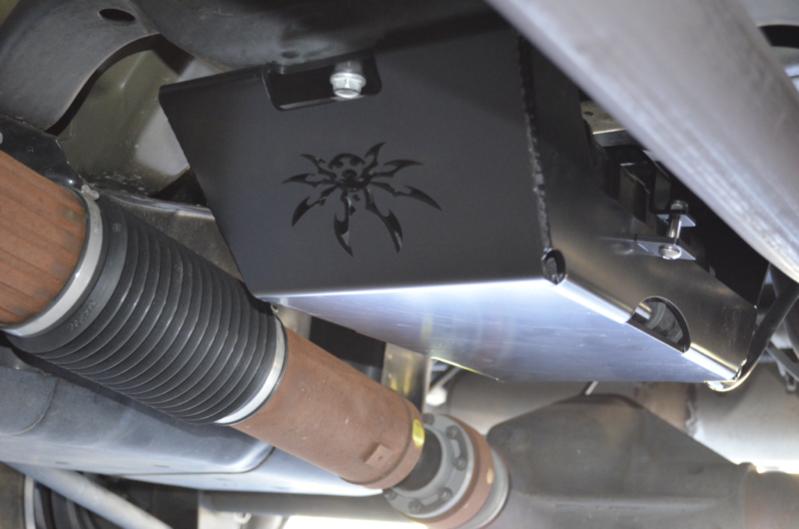

Old Jan 3, 2012 | 01:10 PM
RubiconRod's Avatar
Posts: 136
From: Ventura
Here are some pix of the evap skid installed...
