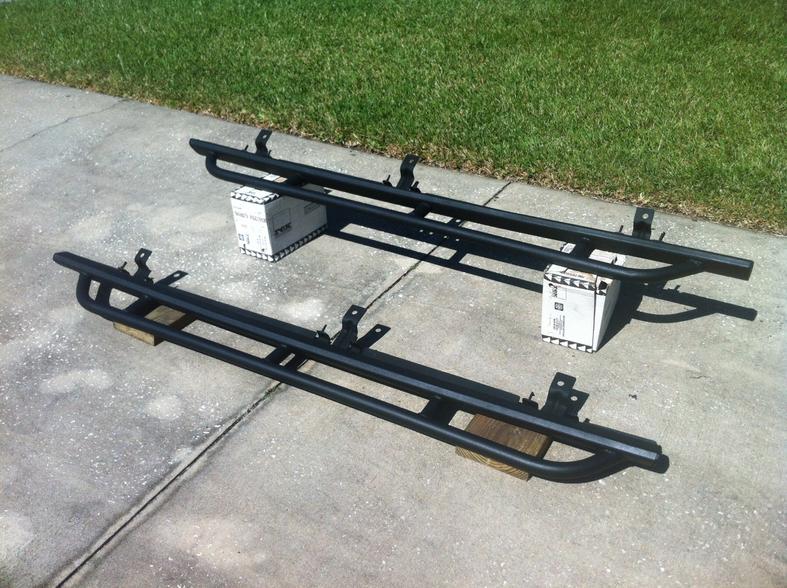

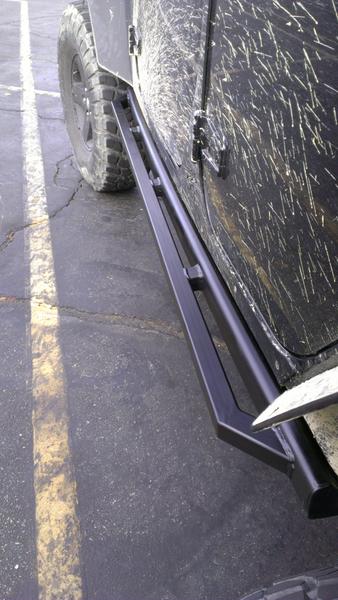

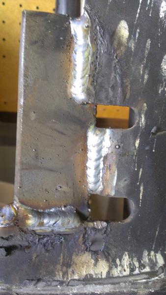

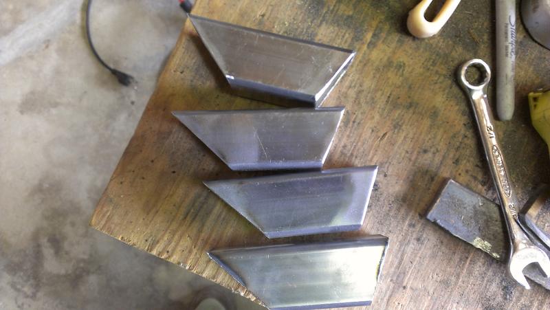

I bought 20' of 1.5", .120 wall square tubing for $36 from a local shop
I made the cuts on the short pieces 45 degrees and 22.5 degrees.

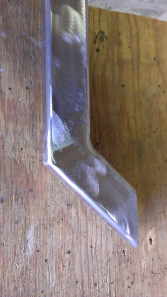

22.5 degree cuts on both ends of the mainslider itself

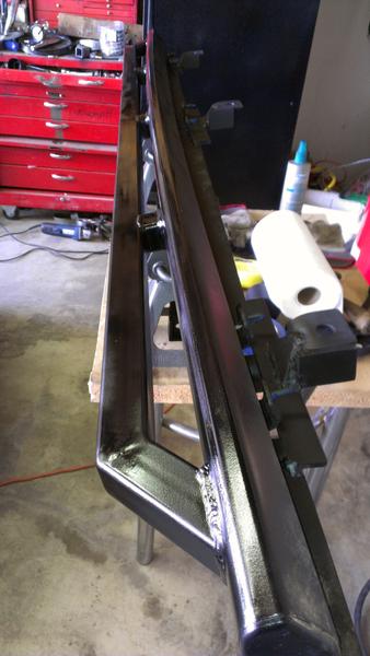

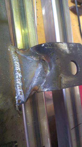

Welded them up and put some.gussets to prevent the thin factory brackets from folding.
Then.painted then with rustoleum satin black texture and installed.
Now what I didnt mention was the little gussets that go between the square tubing and the rubi slider. These 3 gussets were probably the most tedious to do just cuz the rubi slider is curved horizontally and vertically, so I spent a lot of time grinding/ fitting the pieces before I welded them up.

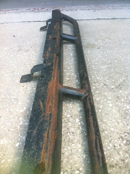

Rubi sliders with tubing welded on

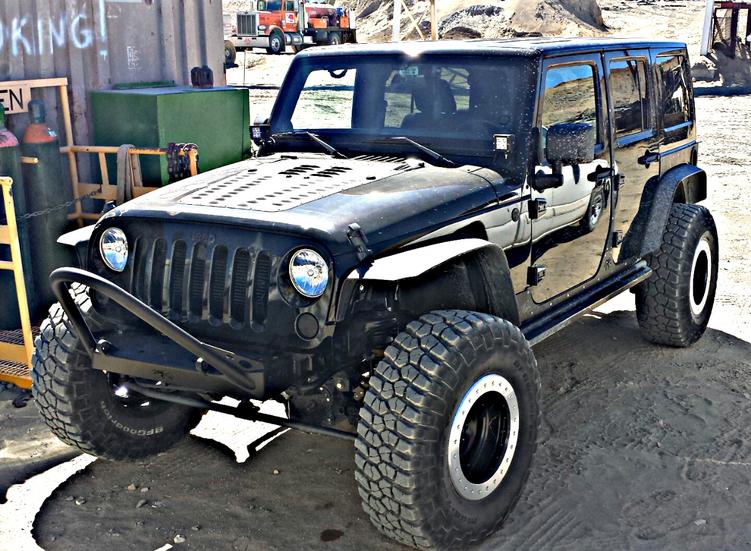

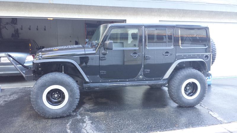

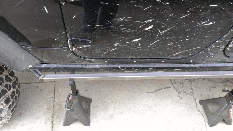

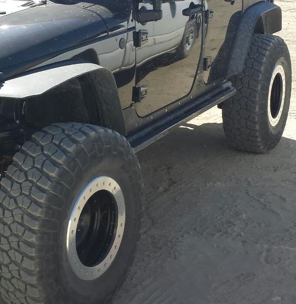

I made those sliders and installed dec 2, 2012.
This pic was taken 9/22/13
Same pic just zoomed it, these sliders are surprisingly holding up reall well, the gussets I made for the brackets underneath are still intact and haven't folded, also still using all the factory hardware to mount these up
This pic was taken 9/25/13
Zoomed in
There is one spot that is slightly bent on the passenger side slider from coming off a big drop onto a boulder big bear on.john bull.
Welds didnt break, rubi brackets didn't fold and I did not receive any damage to the body.
I plan on running these for a long time since they have been holding up so well

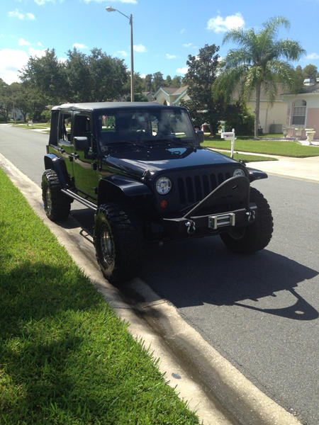

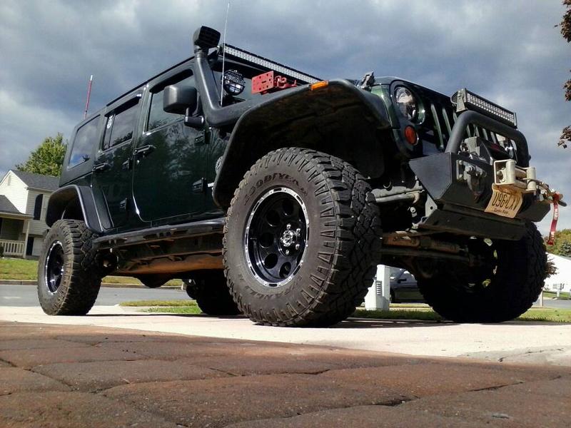

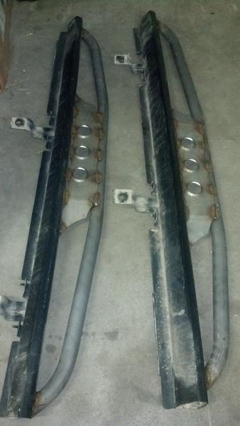

I refurbished a set of modded rubi sliders and they have been great. They angle slightly upward but they are still functional as a step for the wife and kids while not hanging low.
ID:	502524Click image for larger version
ID:	502526Click image for larger version

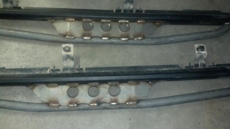

I got the poison spyder ones, got mine welded by a guy at work. Still need to get them painted, I cannot decide to rattle can them or powder coat.

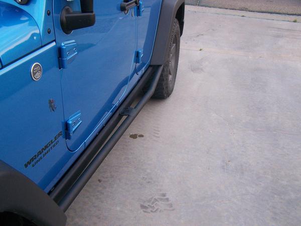

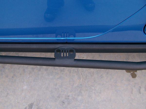

1 1/4" .250wall used 90* elbows and cut a "jeepgrille/punisher" logo for gusset strength/step
