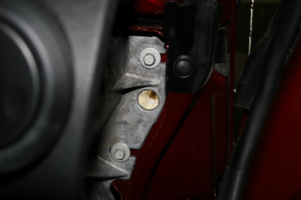

exactly what is was looking for - thanks!
Engine compartment acess hole -
Name:	Engine Compartment Access Hole..jpg

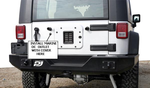

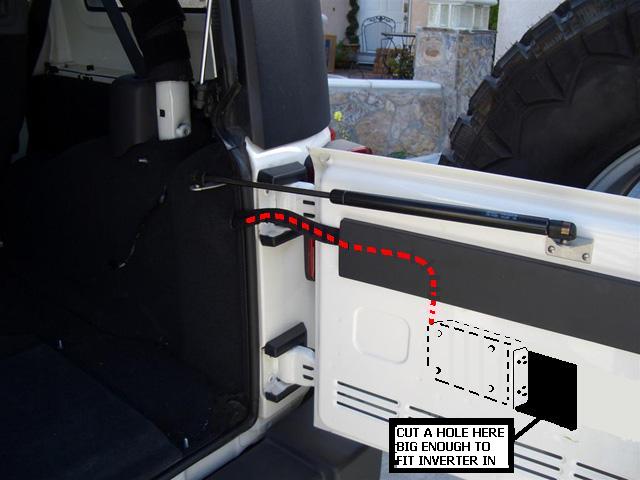

Default here's what i was considering ...
installing a ProMariner inverter inside the rear tailgate, and mounting it so power can be accessed through the hole cut to get the inverter inside. using rubber weather stripping around the hole so there's no ruff edges - and then making a hinged lid to cover the hole when not in use?
then installing an auxillary DC power plug outside the vehicle
ProMariner Truepowers's are supposed to arrive to dealers next week - they are weather resistant and have a GFCI - which is good for wet conditions.
anyone see any issues with this project?
