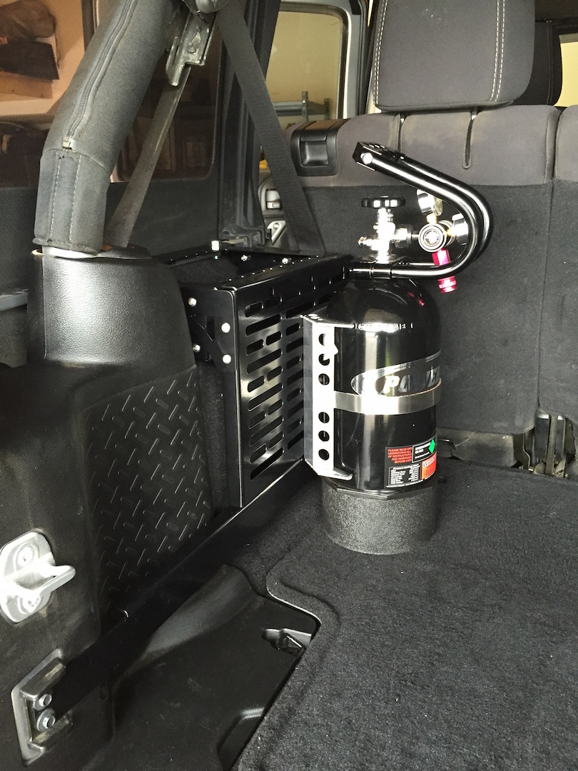

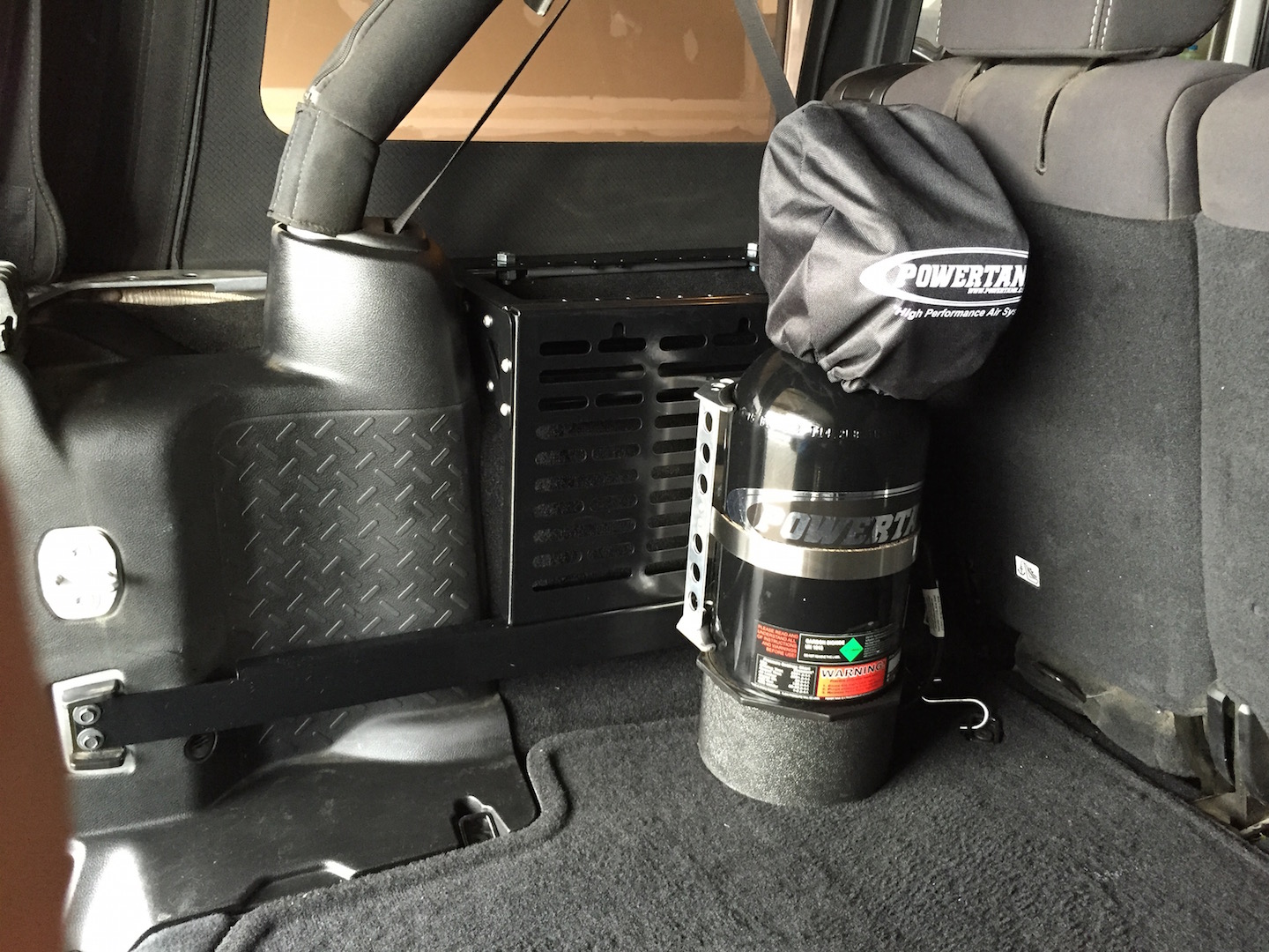

i just got a powertank and LOVE IT. i debated a lot on what to go with. but when i found a shop 3 blocks from work that refills co2 (not just a tank swap but refill) it pushed me over the edge to go co2. way too convenient, fast, versatile. also picked up the springtail solutions bracket and the final result looked like this:
