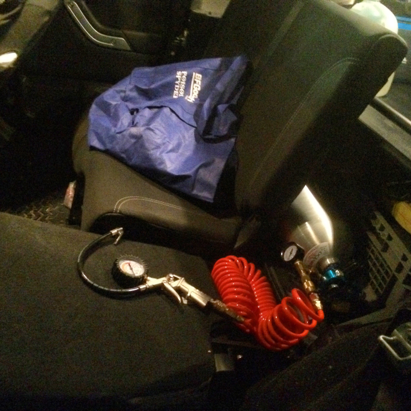

I use scuba tank. Although it's larger than a Powertank, I can fill a tire in the same amount of time of a Powertank and cost only 5 dollars to refill. I can fill roughly 20-25 35" tires on one fill. I would go with a Powertank due to the reputation and support that goes along with it, I went with a scuba tank because I had one just lying around my house. Here is a picture of the set up:
