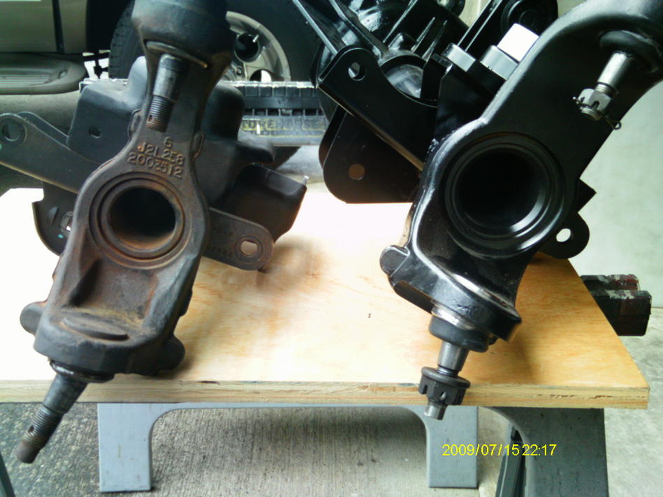

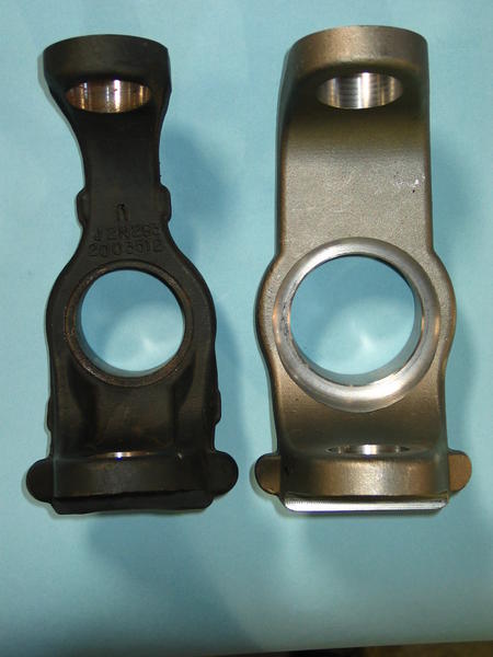

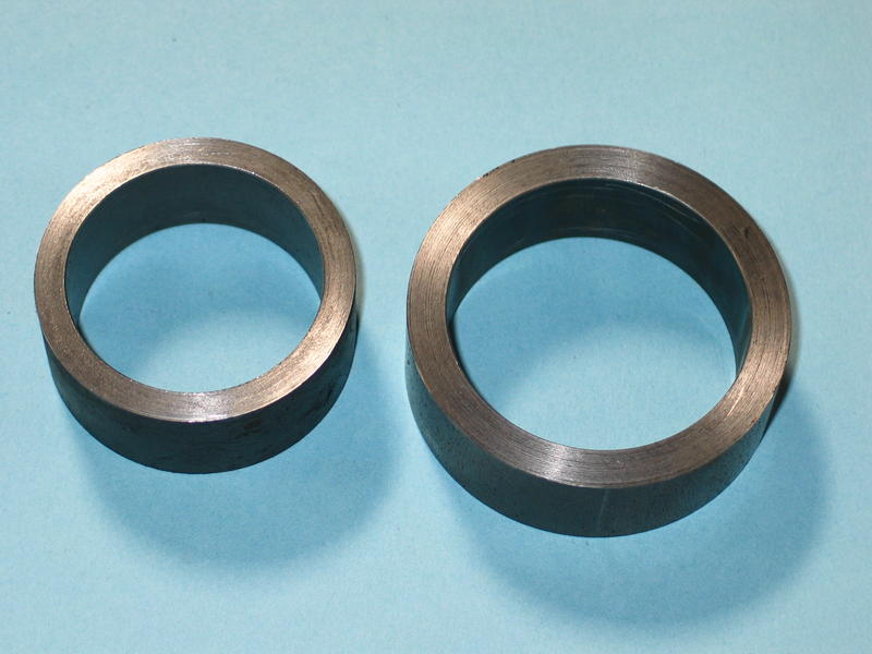

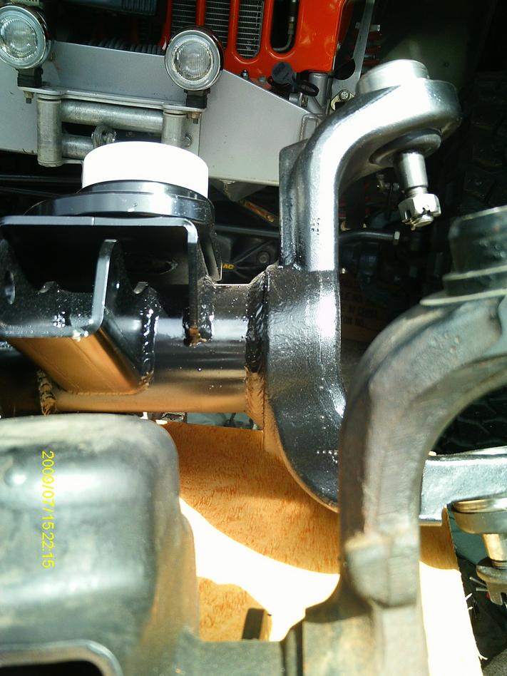

The first thing to consider is the center section. The ProRock 44 is designed for maximum rigidity with extra webbing, a thicker casting and better material. Our ProRock 60 has better ground clearance than the JK 44 and ProRock 44 is sleeker yet.
The standard JK housing with internal sleeves is 35% stronger than stock. With an external clamshell kit the standard housing is 45% stronger than stock. The standard ProRock 44 with 5/16" tube is 113% stronger than the stock housing. The Unlimited version of the ProRock 44 with 1/2" tubes is 182% stronger than stock. The tube picture shown below is our standard 3"x 5/16" tube compared to the factory 2-1/2" x1/4" tube.
The ProRock 44 end forgings (the 'C') are very similar to our Dana 60 version.
Name:	DT-PR44 End forging comparison V1.jpg

Name:	DT- end PR44..jpg

Name:	DT-PR44 tube comparison.jpg
