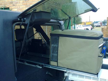

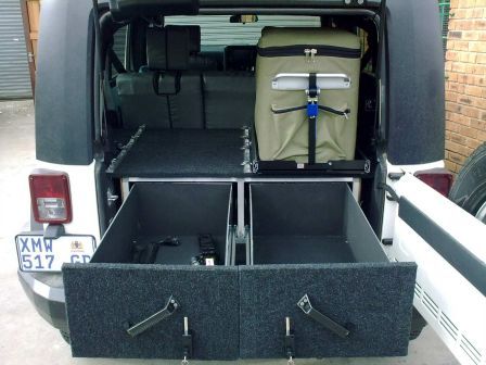

We do trips into Africa every year and this is what i will suggest:
1. Move the EVAP to the back and fit a addtional 90L tank
2. Get a roof rack with tent,water cans and fuel cans,spade,axe. rear working light and high lift jack
3.Satalite phone
4.Winch
5.Drawer system
6.Deep cycle battery and inverter. If you taking a fridge. The inverter will help you to charge camera,lights etc.
7.Get tracks for africa loaded onto your GPS( www.t4africa.co.za )
8.Old man emu is the only susspention that will work for the type of driving you are planning.
Have fun!!!
