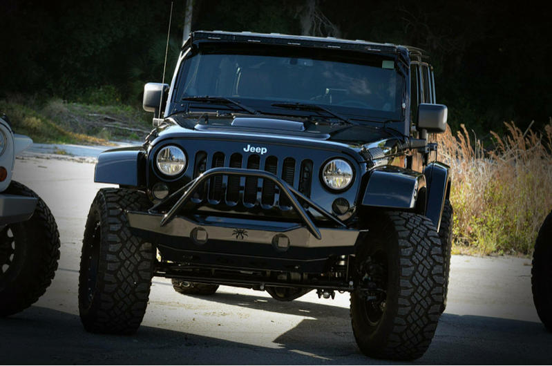

Rock krawler 1.5 with triple rate coils
Running on 35s
