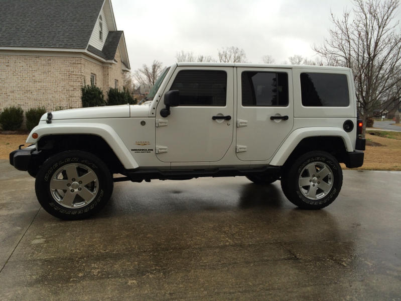

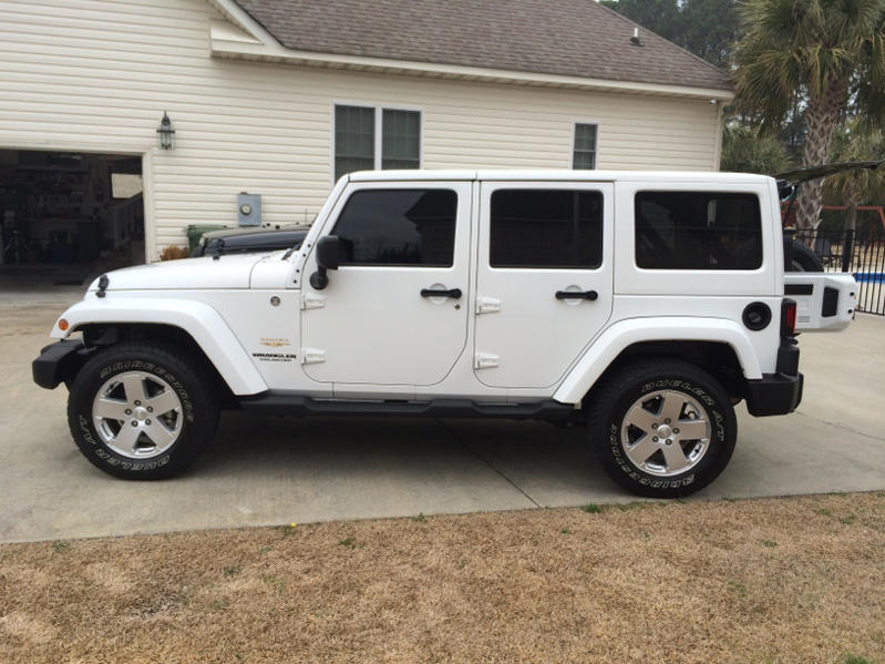

Just installed today the procomp 1.75" spacer kit on wife's Sahara today and it really looks awsome, much better than stock, ready for new tires, prob 33's, before and after...
ID:	538151   Click image for larger version
