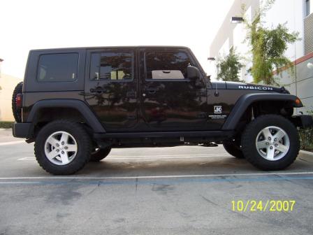

I have had the Pro Comp 4"/2" for about 5-6 weeks now and l'm very happy with it with the exception of the shock bushings. I've been out wheeling twice with it, one of the times there was some fast stuff that really put it thru the test but the I just noticed that the rear shock bushings are SPENT already. Luckily 4wheel parts has the urethane one's in stock for very cheap money. If you go with this lift I would advise not using the bushings that come with the kit and spend the extra $16.00 bucks right from the start. Just my $.02
Here is what it looked like with the lift and stock tires
[img] Click image for larger version
Name:	stock tires 1.jpg
