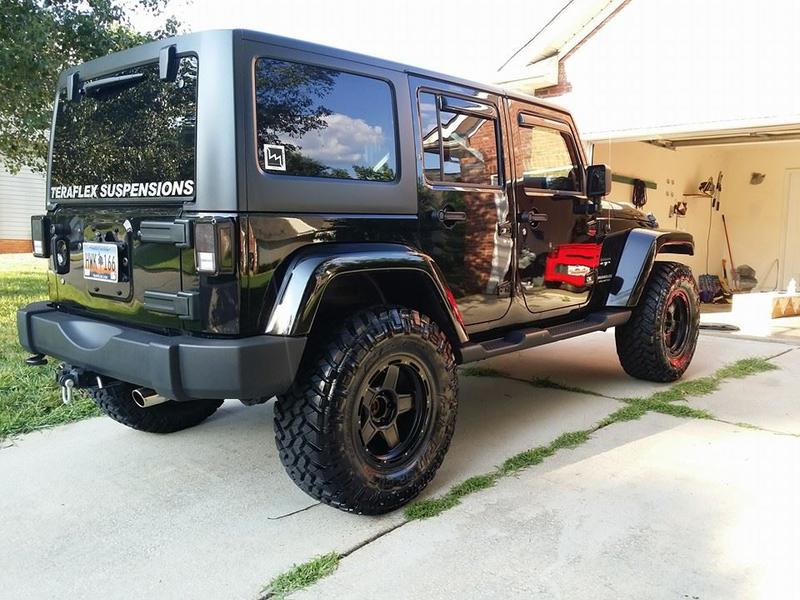

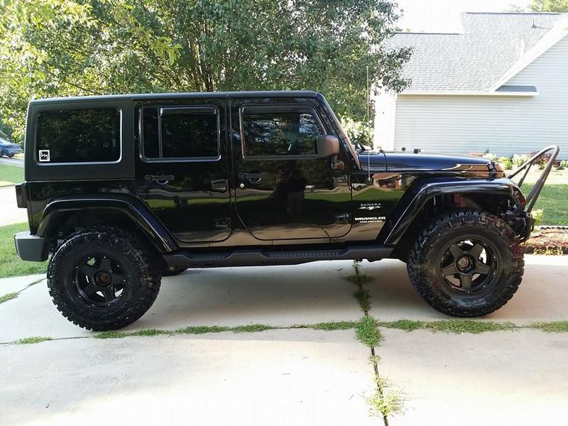

Just got my new Terragrappler MTs and it is perfect!
