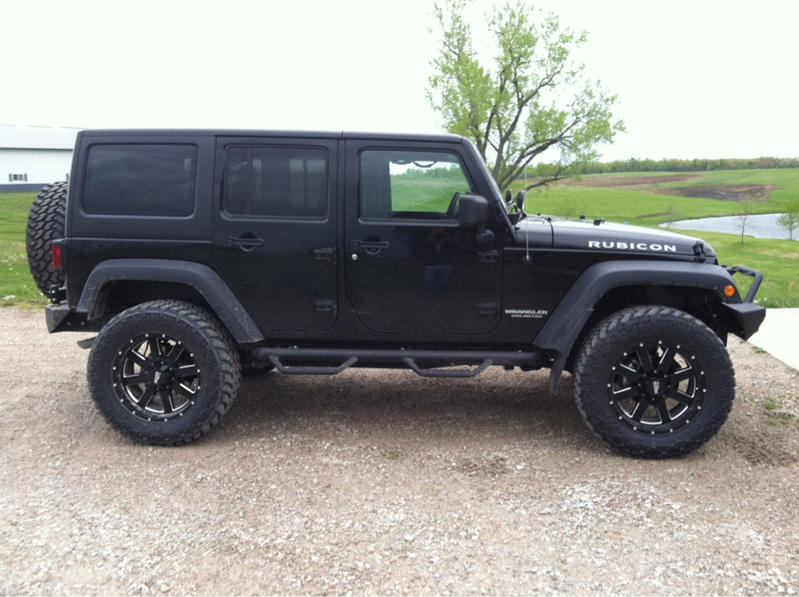

Still working on my handling problem! But since then I have added new Bumpers 10k winch & new steps and some Led spot lights! It's a start for my first jeep! What brand of fender flares should I install ? I don't like the stock rear flares with my new rear bumper it looks like it missing something from a side view of the jeep! Here is some photo's
