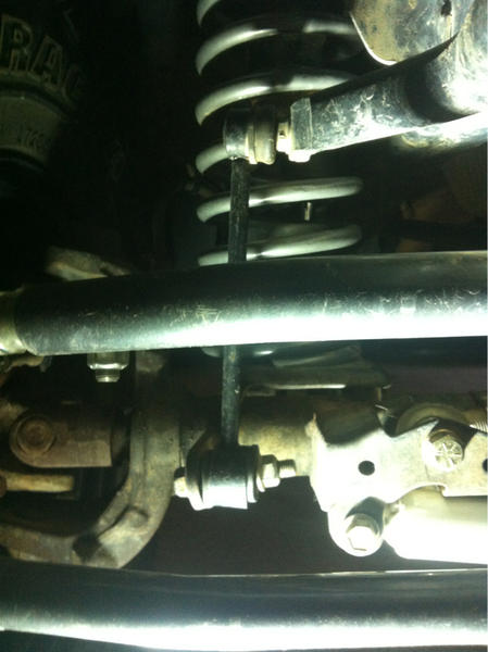

So after wheeling my jeep last weekend I looked under my jeep to find that my sway bar link tabs are bent. I checked to see if my axle was centered and it wasn't so I adjusted my track bar to fix it, but still it looks screwed up, any help would be appreciated with what could be the problem.

do you unbolt the sway bar when you are off road?
you might have tweaked it if you wheel connected

Correct me if I'm wrong but the tab and the bolt look bent still? I would imagine this is why it looks wrong still?

unbolt the swaybar link, heat the tab with a torch and use an adjustable wrench to bend it back into shape. Next time you go offroad, unbolt the swaybar link or get some quick disconnects

The 1/2 bolt looks like its more bent than the tab. I wouldn't even heat the thing and straighten it with a crescent wrench
I second your reply. It looks like your tab is bent. Don't heat the sway at link, you will destroy the bushing. Disconnect it first, then repair the tab.

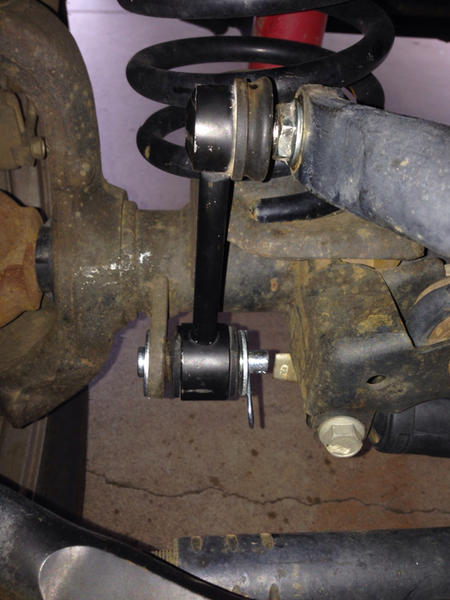

Your lower mount should look mine.
