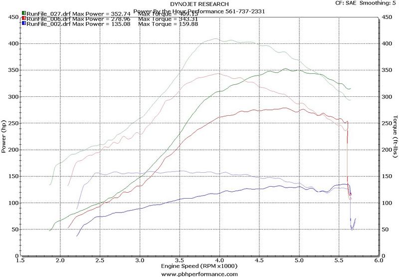

Jeff, can you post a dyno chart for your system installed on a 3.8L Jeep? I couldn't find one on the web site.

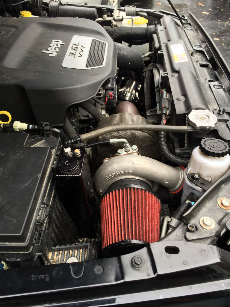

Is it waterproof? these are jeeps that go offroad, not sport cars, so was that concept taken into the design at all?

Here's a chart showing the stock 3.8, Stage 2 turbo, and Stage 3 turbo:

I'm not really sure how to interpret this question (because the stock Wrangler is not waterproof), but here's my best attempt to answer...
Here's where the turbo is located (this is my vehicle, Stage 2 turbo for the 3.6 Wrangler):
The turbo system for the 3.8 Wrangler places the turbo in the same location.
The open element air filter and turbo inlet are a few inches lower than the factory air box. So, as shipped, your water fording depth would be decreased. If you don't go in deep water, but are simply concerned with splashing water, then add a water-repellant air filter wrap (such as OuterWears).
Some customers have modified snorkel systems to work with the turbo. Unfortunately, we have no details to share about how this was accomplished.
There is a vent for the top chamber of the wastegate (which, random guesstimate from memory, is about 1 foot lower than the turbo?). I personally added a banjo bolt hose barb fitting to mine (in place of the included filtered breather cap) and ran a breather hose up to a higher location just to ensure I don't get any dirty water splashing in there. If you want to do this, ask about including a spare hose fitting for the wastegate when ordering.
The BOV is up fairly high (in my picture, it is the shiny part just below the black silicon elbow that connects to the throttle body), and I have no plans to go in water that deep, so it doesn't concern me. If you are trying to turn your Wrangler into a submarine with a snorkel, etc., then you would probably want to use the Tial QR BOV instead of the included TiAL Q. The lower body portion of the QR can be purchased separately to convert a Q into a QR. This would allow you to run a hose from the BOV to a higher location - or even to your snorkel tubing for a fully re-circulating system. At this time, I'm not sure if the Tial QR is an option that could be included with the turbo system initially to save you the hassle of converting it yourself. I'm curious myself now, so I'll get an answer about that.
And finally, I'd just like to point out that not every Wrangler is taken through extreme off-road conditions, deep water crossings, splashing through mud holes, etc. In fact, most Wranglers do not see extreme off-road conditions. If you don't do any of these things with your Jeep, then the turbo system as-is out of the box is great. If you do play in water, then you can modify the system to protect against water intrusion to various degrees as necessary.
