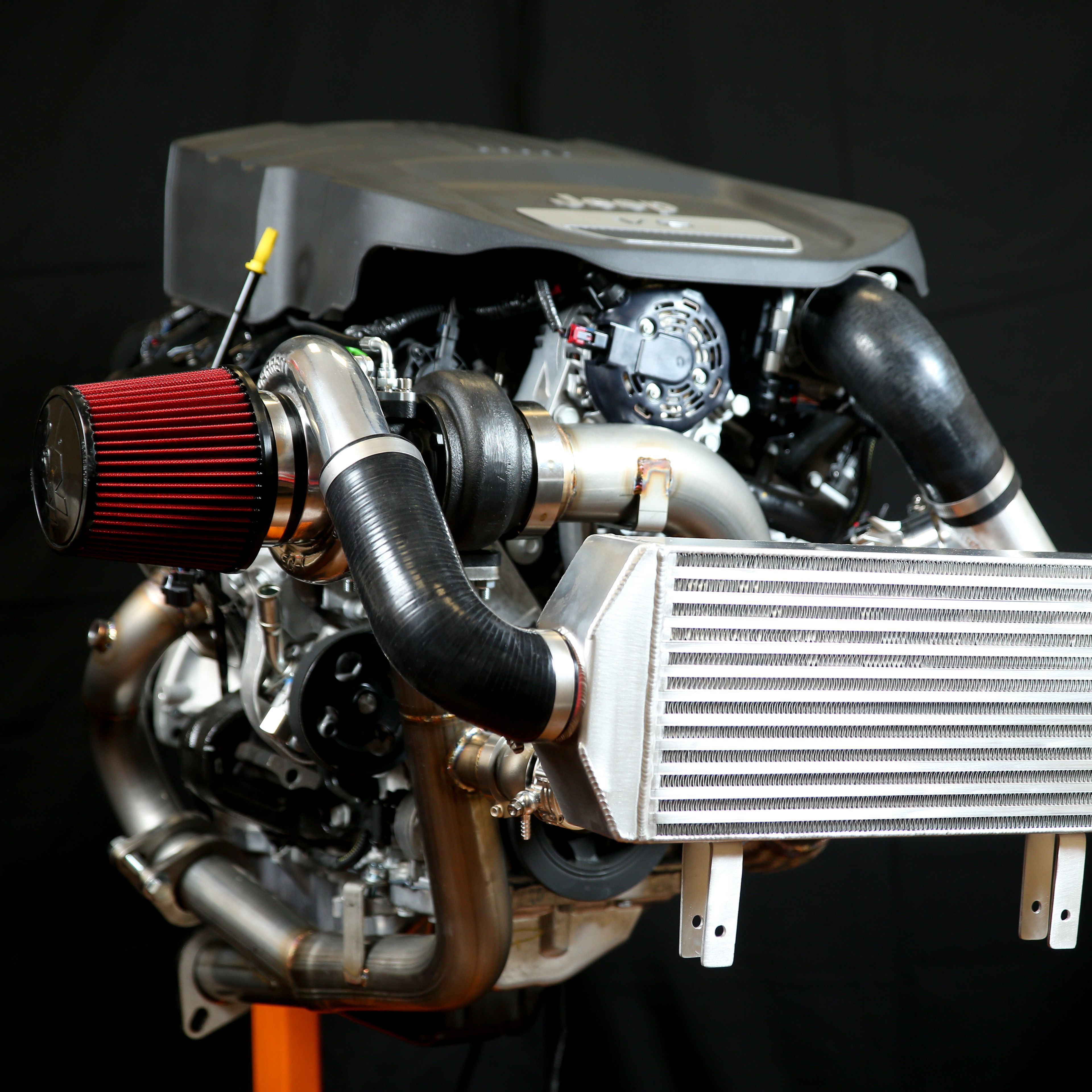

In the picture of the 3.6 turbo system in my previous post, the BOV is partially visible peeking out above the intercooler on the right side of the picture.
