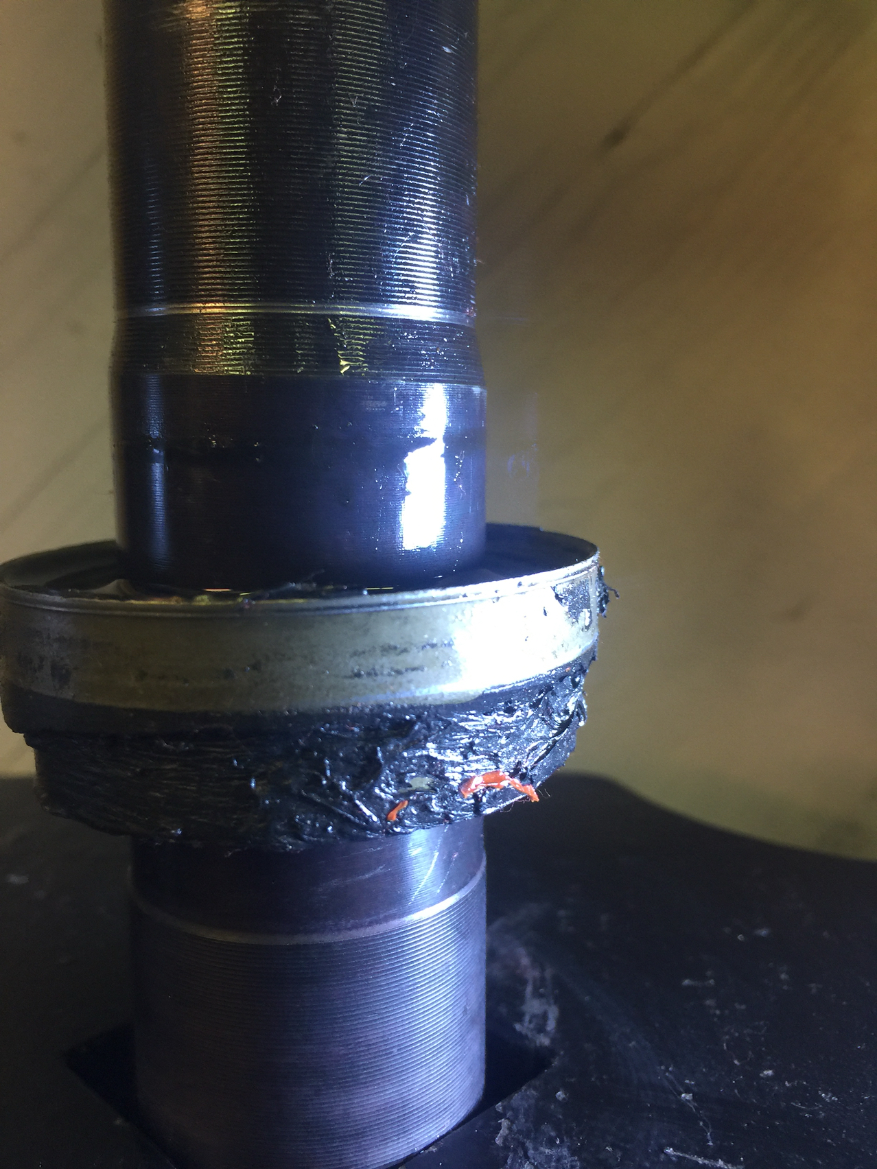

Well I decided to use my experience and people with years of automotive experience opinions. And I'm currently testing my theory about using silicone on the seals. In the years that I turned wrenches professionally I never put silicone on seals. When I first pulled this apart and saw it, I was in shock and even called dynatrac and asked if they normally use silicone and the gentleman said yes. So before I pulled it apart for the second time both sides are leaking. I decided to replace just the short tube seal without silicone and just clean up the long tube and see what happens. Visually inspected long tube from where the carrier sits and just like all of the seals I have sitting around now, none are torn. After a few days of driving long side still leaks, short side however is dry as could be. That's about a week of driving roughly 125 miles. I have noticed that the long tube only leaks when it's angled downward. Tomorrow I'm pulling it apart for the third time to replace the long tube. And hopefully no leaks.

Ok finished up the seals for the third time now without silicone and took it for a short drive and there's nothing. Time will tell on this. So I'll be driving the jeep to work for the week and see what happens. I did for shits and giggles come up with a way to test and see if "I tore the seals". I took one of the old ones that was leaking and put it around the shaft and filled up the wet side with air tool oil which is very thin. And let it sit and there was zero leaking. I waited about 10 minutes and then I twisted the seal and moved it down to see if there was any change, none. Then I let it sit for 30ish minutes until I needed the shaft for reassembly. There is three pictures showing that I completely filled it with fluid and another three pictures showing it remained dry. Ruling out a torn seal.

ktoh87, sorry this has been such a struggle for you. Leaking axle seals are a pain in the butt on a front axle. There is a lot of teardown and re-assembly to get access to them. It sounds like you may have this fixed, but here is some tech for the future. Hope it helps ktoh87 and anyone else out there.
The static leak test you performed was a good idea. Unfortunately it does not replicate the rotation of the shaft. Oil is either escaping from the lip/journal interface, or around the outside of the seal.
Silicone around the outside of the seal body is cheap insurance. Seal bodies can deform during insertion and press-in.
Dynatrac PR44F axles get a seal-housing insert pressed into the inner end of the tube. This is done to enable customers to upgrade to 35spl shafts at their convenience at a future date. It is possible, but unlikely, that oil is escaping between the OD of the seal housing and the bore machined into the tube. We use a Loctite compound and a press fit to mate the 2 pieces. If you suspect this is the case, it can be easily sealed using some silicone around the seam. It is visible and accessible where you insert the axle seal. Just clean it well, and smear some silicone around the seam.
The more likely cause is the seal to shaft journal interface. Installation damage is usually the #1 cause. The splines are sharp, the seal journal can get scored in handling, and it’s an awkward insertion due to the length of the shaft.
Seal journal condition is the #2 cause. Seal journals must be ground to a 16 finish. If the journal is too rough then oil will escape under the lip. If this is happening even a microscope may not show any lip damage, so don’t let the condition of the seal lip prevent you from further inspecting the journals. The run out of the journal is also a potential problem and hard to detect. You must indicate the journal from the CL of the U-joint (Not easy to find or hold) and the CL of the splines. Depending on who made the shaft the centers in the part (if any) may not be the true CL of rotation.
Journals can be too small or too large. Too small, and they do not have enough lip pressure to repel oil back to the sump. Too large and the lip gives way. The seal journal can also be too polished or too shiny. The lip is lubricated by tiny amounts of oil working in between the lip and the journal. Shaft journals too shiny, burns out the seal lip quickly from lack of lubrication.
There are 2 ways to inspect the journal. You can buy “finish standards” from a grinding or machine shop supply house for a few bucks and compare the finishes on your shaft against the standards. Scratching both with a fingernail does this. Its all about experience and feel. If you have neither, a better way is to use an instrument called a Profilometer. Not something that you will find outside of a well-equipped grind shop or lab facility.
A bad seal is the #3 cause. Lately we have seen brand names like Timken, CR, SKF and others re-boxing imported seals from overseas manufacturers. I find this very distressing, and almost impossible to detect. All seals are not alike. Their durability, tolerance of journal finishes, elasticity, material quality, and ability to repel oil back to the sump is the secret sauce that makes one seal great, and one seal is crap. Good seals and shafts aren’t cheap, and cheap shafts and seals aren’t good. That said, even a domestic, well made part can be defective. It just happens way less often.

Good news, I've driven about 250 miles and had the jeep flexed on my lift for roughly half hour each side and no leaks. So everyone can be their own judge if you have this issue. I can say I used cheap oreillys seals, cleaned the old silicone out and DID NOT use silicone and nice and dry.
