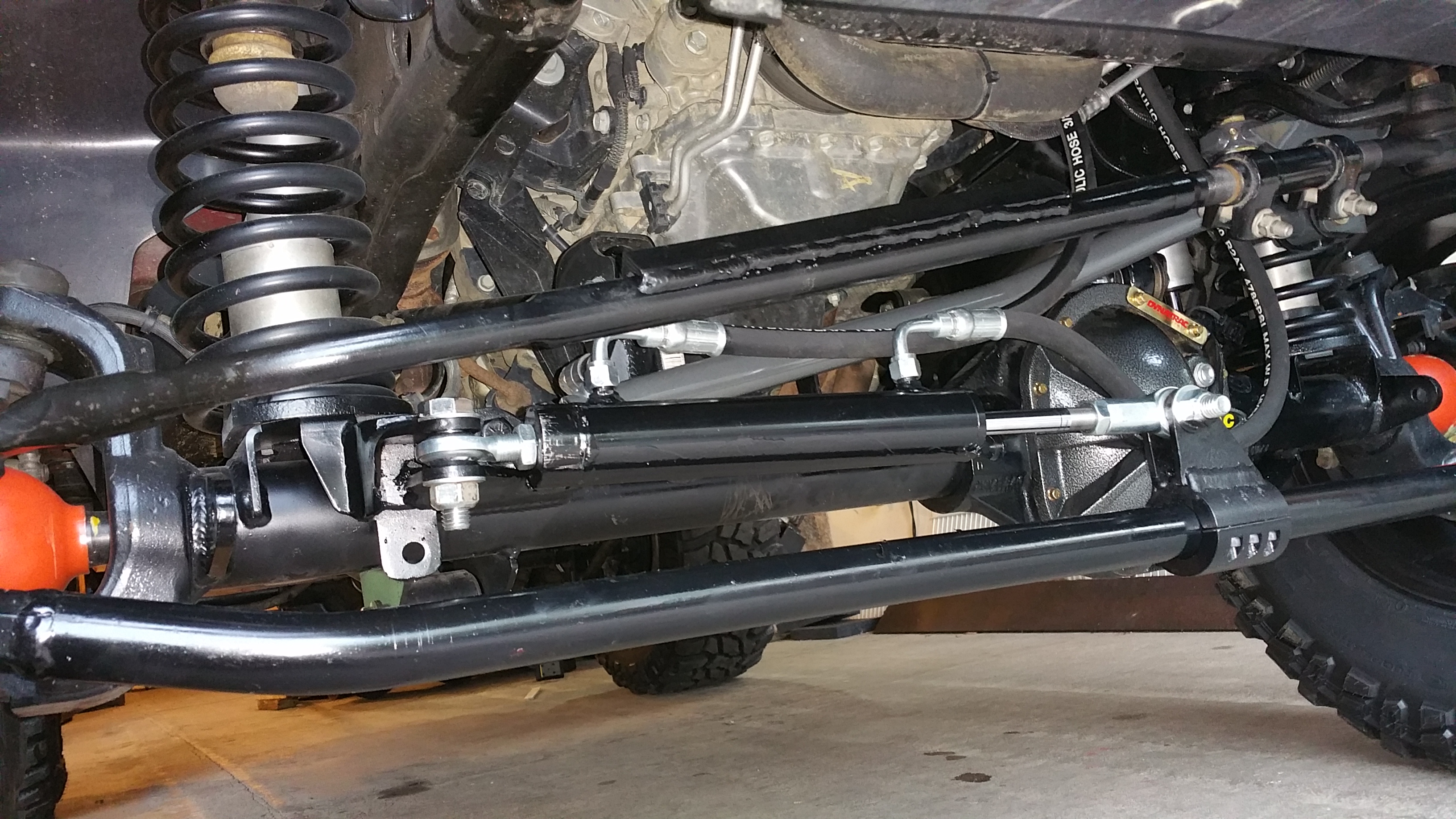

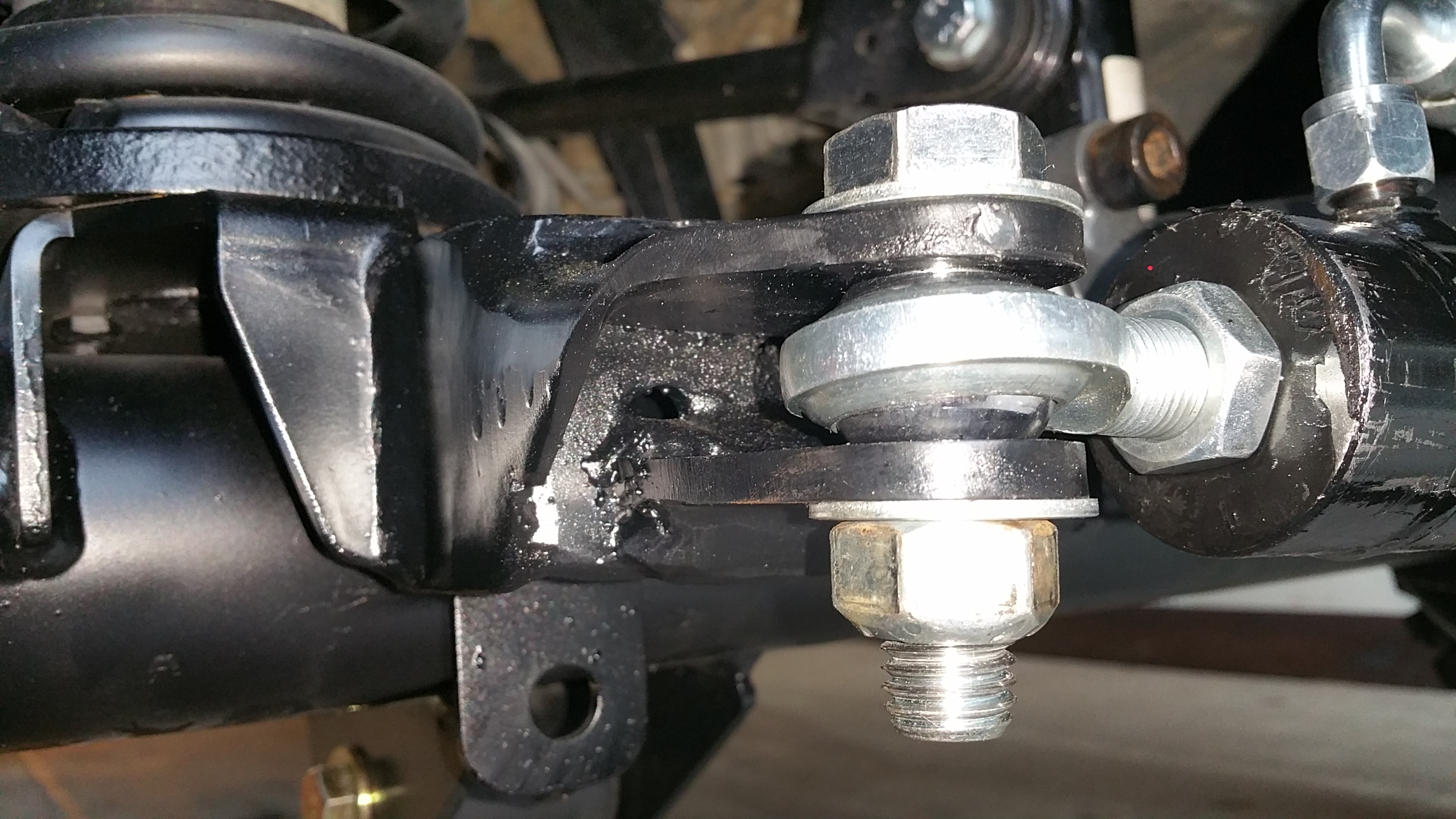

Just picked up a used PR 44 Unlimited with the standard track bar bracket welded on by Dynatrac. I am wondering if anyone was able to weld their hydro assist tabs to this bracket. I'd say its atleast 3/16" steel with 3 solid connection points to the axle, just don't have much frontal surface to mount the tabs without interference from the track bar bolt. Any ideas beyond cutting it off and welding a new one are appreciated, I do not want a raised bracket. Called Dynatrac they said if I reinforce it, it will be strong enough, I'm hoping for pics of someone else that did something similar.

Easy peasy.

Great Pics, exactly what I needed, Thanks Larry!
