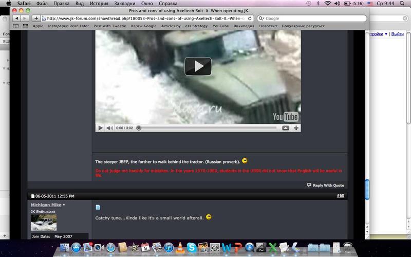

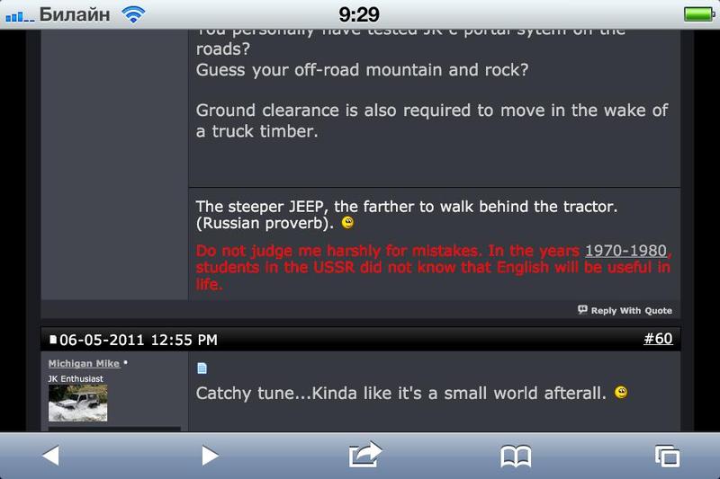

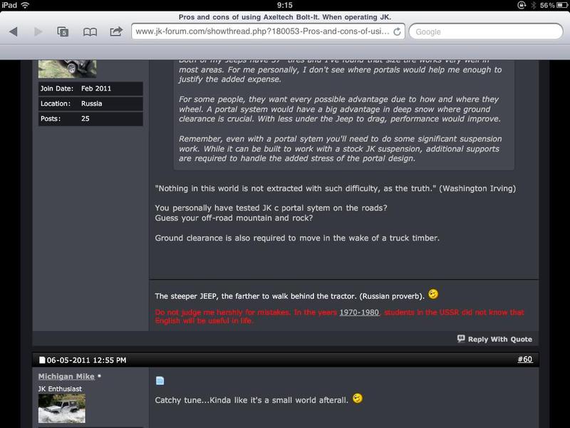

Default Why iPad and iFone filtered Yu Tube on the forum?
I do not understand why iPad and iFone filtered Yu Tube on the forum. Is this normal? MacBook misses a forum Video Yu Tube.

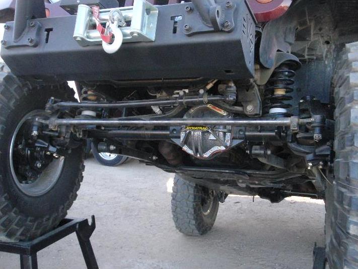

Does anyone know whose it work?
Who was doing this project? Click image for larger version
Who was doing this project? Attachment 171073
This is a Dynatrac JK that was shown at KOH. The AIM/Dynatrac system bolts to factory mounts. This was done for display only to gain customer feedback. It has not been tested for durability.

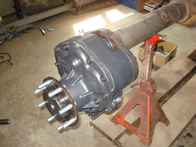

I saw the D44 version on my latest JP Magazine. Here's the note:
"AxleTech International Motorsports introduced a smaller version of its portal axle ends that fits late-model Dana 44 axles. The portal boxes provide a 4-inch lift and have a 1.25:1 reduction radio. The knuckle is made of steel and the gearbox is made of aluminum. The boxes are available for both front and rear axles and come with a 5-on-5 pattern."
I emailed them some questions but the guy was out of the office. I hope to get his reply this week.
I hope the "smaller version" also means smaller price tag.
The portal end shown in the picture doesn't have brakes, this could mean that stock brakes can be used. This could also mean lower price and the ability to retain the speed sensors, if I'm not wrong.
