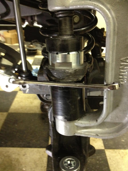

I am not sure if anyone has installed prosteers but I recently have found the upper ballpoint install is kinda a pain because the install sleeve wants to tilt and interferes with ball joint
This may not be correct way of doing things but it worked fine for me on both sides
The key beforehand is to ensure no metal burs are on knuckle and have anti seize on ball joint as per instructions
I started to seat the ball joint first then when lower sleeve started to tilt I back off enough to shim with a 1/2 end wrench and finished pressing on the ball joint
