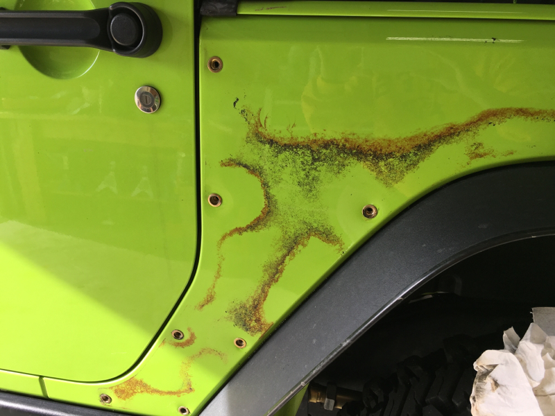

Without a seal, there is enough gap to wash between with water. It's also enough to dry out of moisture gets in. With a seal, stuff will still get in except the seal does a great job of holding it in. Constant moisture is your enemy and a seal will get you that.
Same thing with axle seals. Crap still gets in, but can't get out.

Here you go, this is what was waiting under my corner armor a year after it went on. It's not as bad as it looks. The rust was actually from the armor itself not being prepped properly and was transferring rust into the clear coat of my paint. The nutserts did not provide any standoff and instead my body was slightly warped and puckered which just made the two rub together even worse. I could see running a gasket along the top edge of the corner armor to keep water from going down in and then not sealing the bottom so that any moisture can drain out. Not sure how well that would work or if it would even help at all.

Second invest comments. I am a corrosion specialist and the gasket is likely to cause more harm than good. Not having it there will allow the space between to "breathe". The biggest thing is that you coat both sides of the armor regardless if it's steel or aluminum. Dissimilar metals touch will cause a circuit to form and will cause the less noble metal to corrode.
Forget the gasket and coat your armor properly and you will be good to go.
I've got Evo's aluminum rockers (with VKS sliders) which I'm planning to have painted body color. I have heard about the corrosion possibilities if using a rubber liner like the one PS offers. Interesting since Evo's instructions actually call out the applying of a gasket sealant to their rockers prior to installing....
I'll probably skip the sealant...
