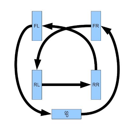

Thanks for your input everyone! There is always things to learn, and this is a great place for it! I have found with chalk test and ride preference, 30 is my magic number, daily driven. Thanks again everyone!
Note that if the ambient temperature drops or rises by much, or if changing elevation, up or down, by, say, 6000 ft. or more, there will be a change of quite a few psi.
BTW, for lengthening the usable mileage of the tires, it's a good idea to rotate them (including the spare wheel) each time the Jeep is serviced.
There are a few way to do it, this is one example:
Name:	Wheel Rotation.jpg
Provided that the spare is similar in size to the other 4 tires, including it in the wheel rotation, reduces the tire wear by 25%.
Tires have limited shelf life even if not used, so a spare that hadn't been used for 3 or 4 years (especially in hot weather) isn't reliable anyway.
<img src="https://www.jk-forum.com/forums/attachment.php?attachmentid=599352"/>
I realize about tire rotation, I've rotated the tires frequently with all my vehicles for as long as I've been driving, and will continue too with my jeep, as well as my matched spare. But thanks.
I didn't assume that you didn't know about tire rotation... and couldn't know that you do it anyway.
There are many who read this forum, that's why I often elaborate a bit more. If just one Jeeper adopted tire rotation, because of this thread, the forum has justified itself.
