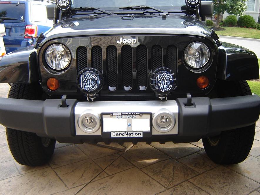

I installed a set of these about a year ago and have had no issues with the lights shaking or moving.
