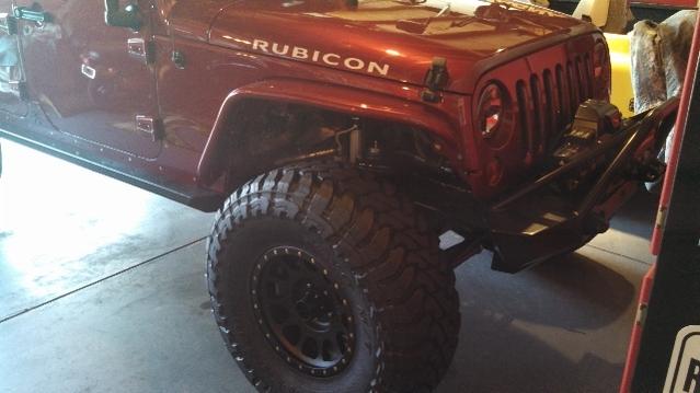

Originally Posted by 36Fan
Cole Trickle...thats one of the cleaner looking Jeeps I've seen!! Nicely done.
Thank you....
I am very happy with how she turned out. I like round two even better...lol

Old Apr 4, 2014 | 04:27 PM
36Fan's Avatar
Joined: Dec 2013
Posts: 160
From: Ca.
Originally Posted by Cole Trickle
Thank you....
Attachment 543276
I agree..looks great.
