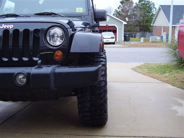

Which is basically what I'm running. This photo should give you an idea of how wide that actually looks with 285/75R-16 (slightly over 11" wide) tires:
