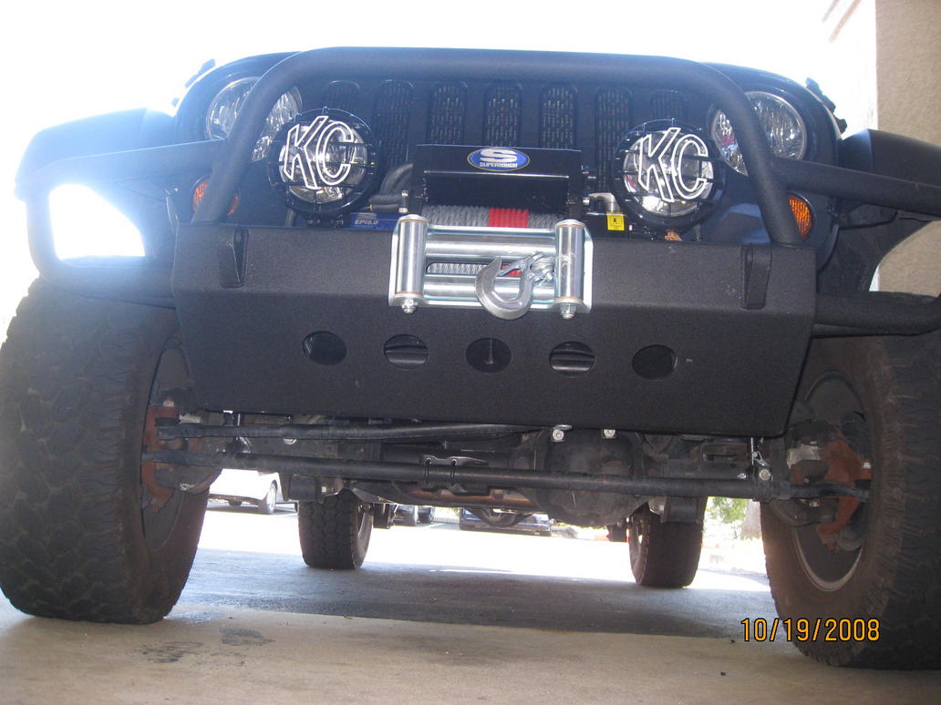

Old Oct 19, 2008 | 04:24 PM
Augie's Avatar
Joined: Sep 2006
Posts: 856
From: SFV-LA, CA
It protects from frontal approach up until the cross member?, but if you were to be hung up on a rock it won't. will add a pic later!

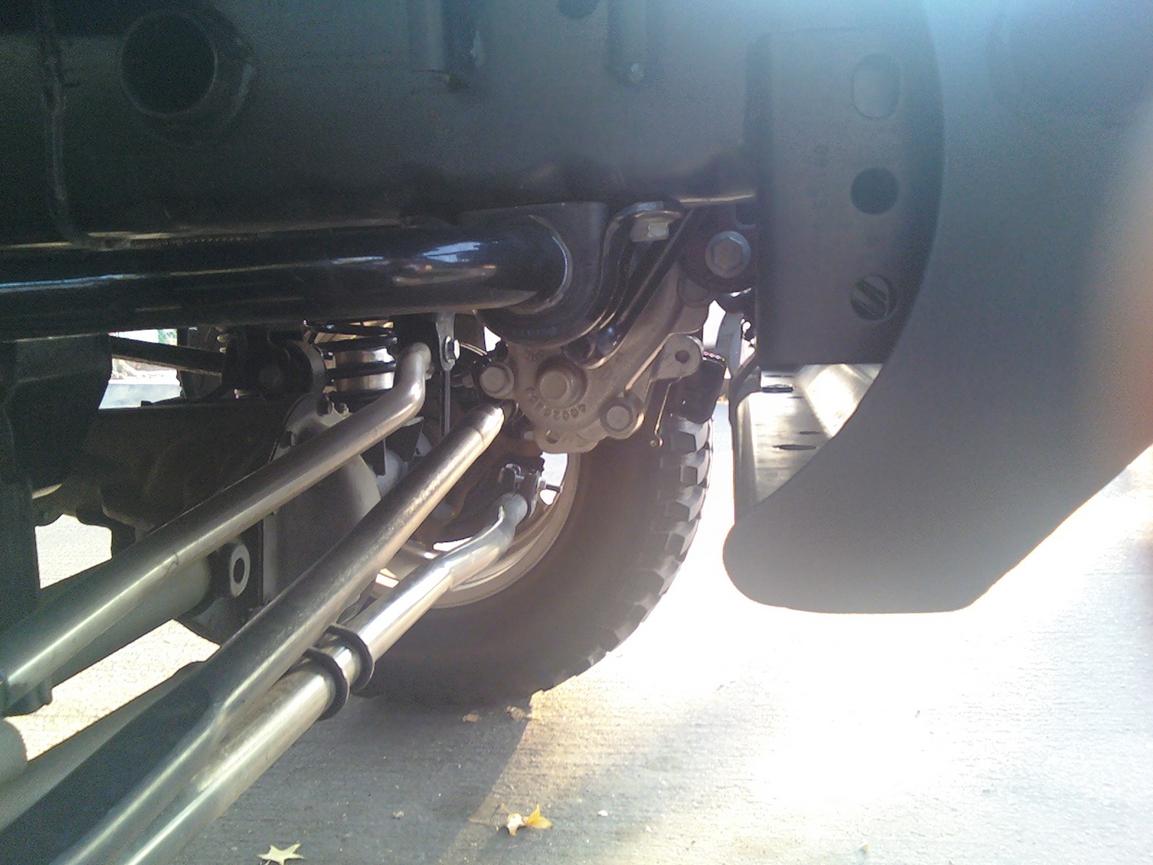

Old Oct 19, 2008 | 05:31 PM
SteelMastiff's Avatar
Posts: 703
From: Great Lakes
Here are some pics before I rotated the E-Disco, as you can see it is in harms way; but after I rotated the motor up, it sits at least 2" above the cross member... It makes a huge difference with the motor rotated, like metioned already you would have to drop down directly on top of a rock for the motor to be contacted, but it is still exposed. I don't have any pics after I rotated the motor, but I could take some for you tomorrow.

Old Oct 20, 2008 | 07:04 PM
Augie's Avatar
Joined: Sep 2006
Posts: 856
From: SFV-LA, CA
Here's a pic of pass. side view.
