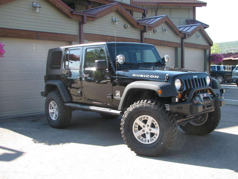

As well feel free to give me any other ideas on which wheels to run. I'd like to run a black wheel. Here is what they will be going on.

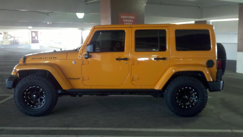

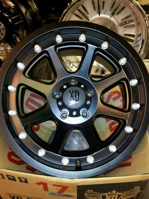

Went ahead and ordered some Fuel Boost wheels! Should be here next Tuesday
